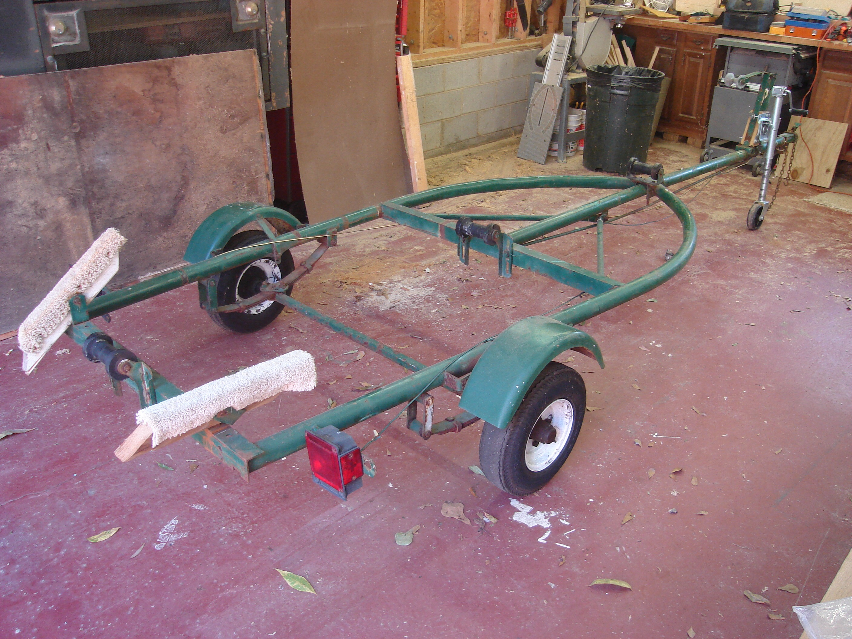

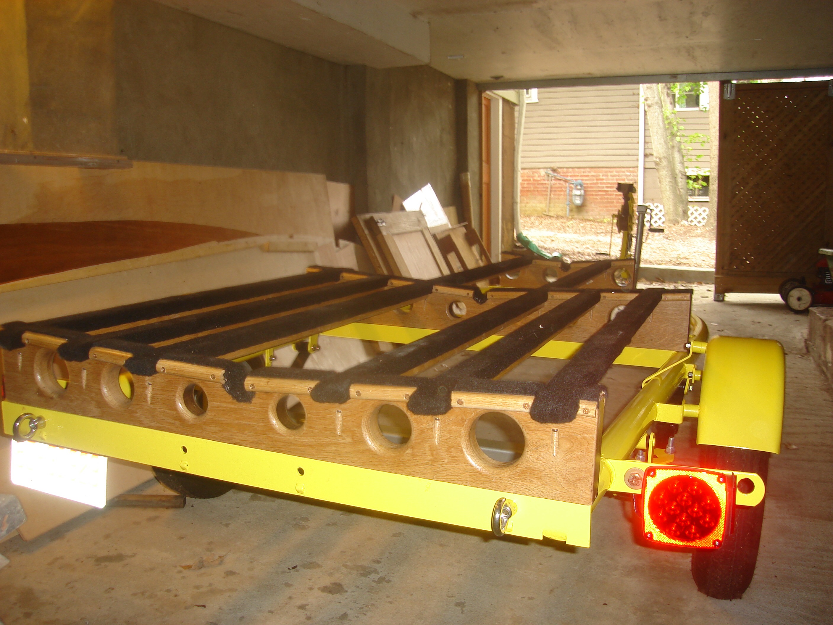

March 8, 2016 at 1:15 am #33093Mine wasn’t a true "Gator", but it was made by the same company and called a "Champ", and did have a "Gator" winch. It came with a bent tongue and an axle that was scrap metal, with the axle seal surface shot and one spindle bent badly.
I straightened the tongue, and since it was for a ‘special’ boat I was building, gave it a new oil bath hub axle, then had to space the fenders out a tad further to accommodate the new wider axle. Trying to work smart rather than hard as I get older, I took it and had it sandblasted, and when they said for $400.00 they could powder coat too I said done"
Ran all newwiring and LED tail lights, and replaced event bolt and nut, even the bushings for the leaf springs, and I was able to dump the rusty 8" rims and upgraded to 12" rims.

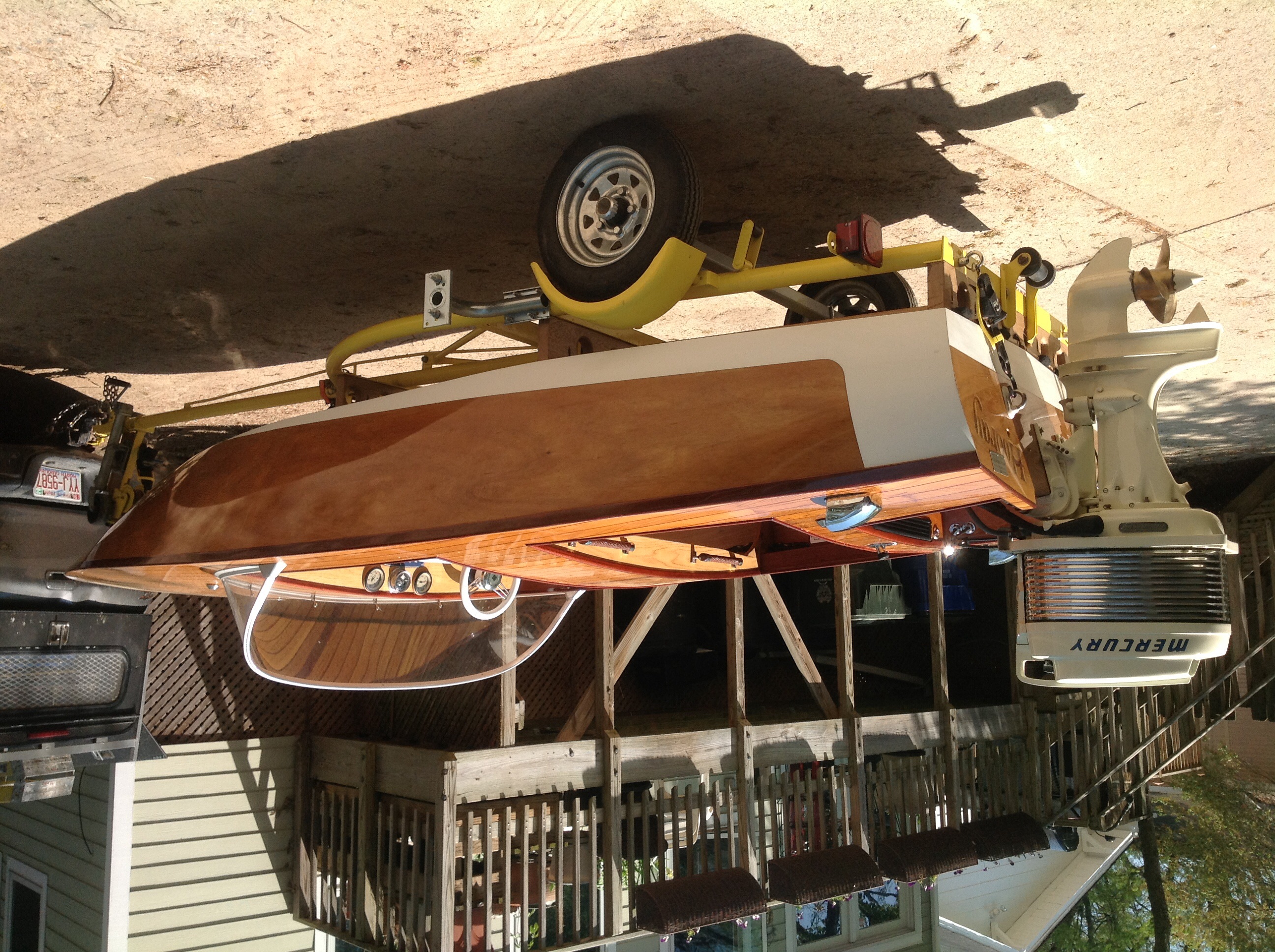

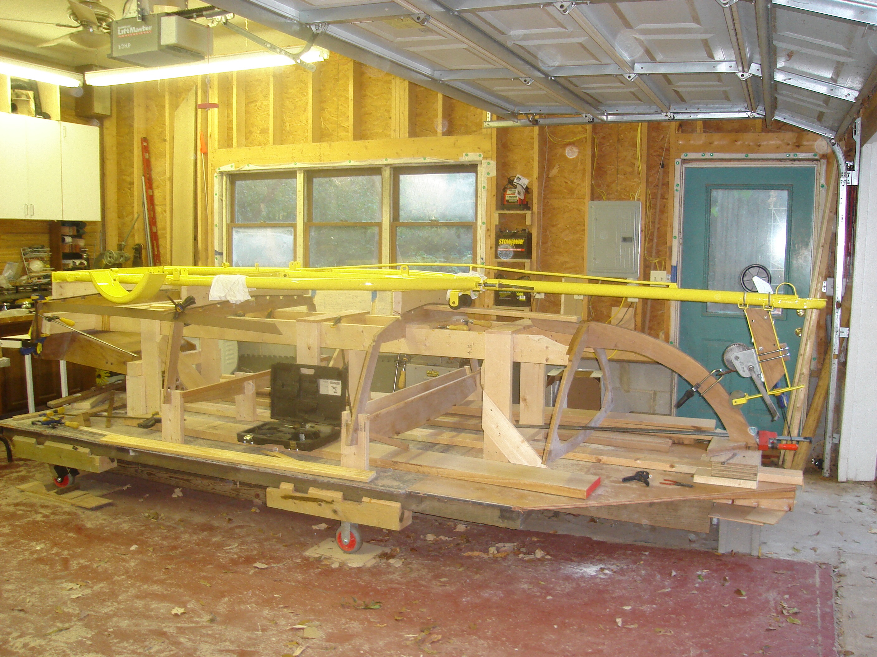

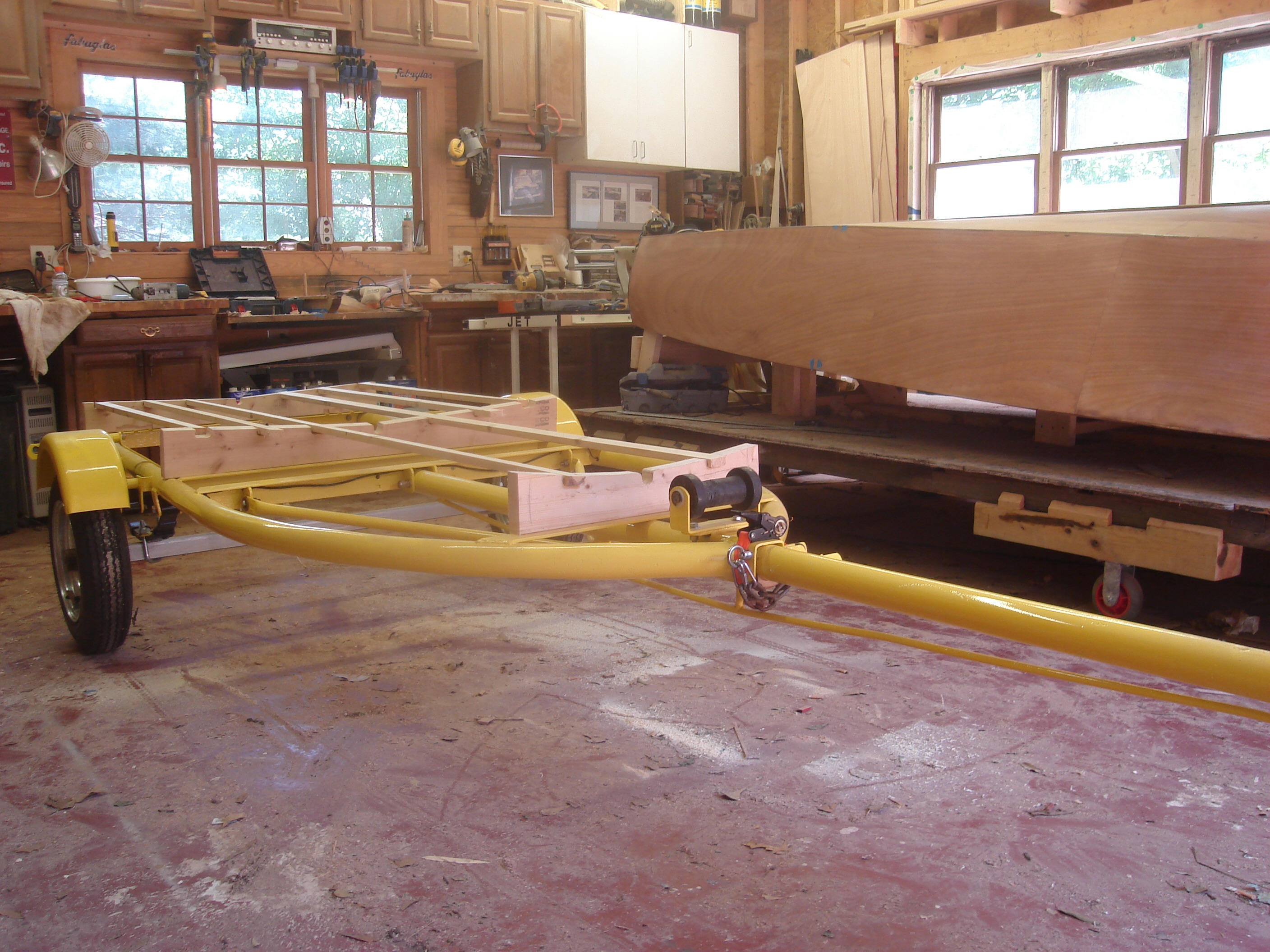

March 8, 2016 at 1:20 am #33094I used an unorthodox method to fit the trailer to the boat, placing the trailer upside down on the upside down frame of the boat. Thus allowed me to locate the bow eye in the stem of the boat to align with the trailer winch.
It also allowed me to fit custom cradles and battens for the trailer to perfectly fit the shape and position of the frames and floor battens in my boat. Rollers are not appropriate for wood hulled boats.
March 8, 2016 at 1:27 am #33095March 8, 2016 at 2:59 am #33100Gd, beautiful job on the trailer and the boat!
