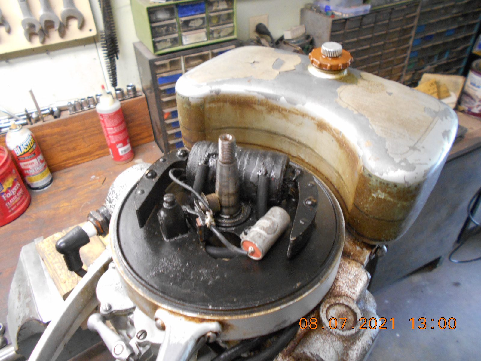

        Here’s a conversion I did on a similar looking 1940 Elto Evinrude Handitwin
        using OMC universal coils. Runs good.
        Careful planning to see if it’s possible on your motor recommended.
        DSCN1582
        DSCN1602

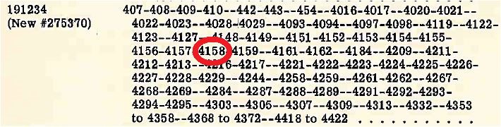

          It seems to be a common coil and was used in a myriad of motors back in the day. A good replacement shouldn’t be too hard to find.
          4158-Coil

              Thank you for pic and information ,was wondering what you used on your motor for the white contac

                  He asked … “was wondering what you used on your motor for the white contac”
                  I’m guessing that you are asking about the white capacitor that shows on Bucc’s motor… Looks like a modern foil capacitor?
                  Joe B
                  #258109
                    Yes, modern electronic capacitor from DigiKey, not sure what mfd was used.

                      A 4158 model is a 1936 2.5 horse Handitwin and the capacitor (condenser) for it should be rated at 0.10 uF (microfarads).  These Vishay caps from Digi-Key will work well.
