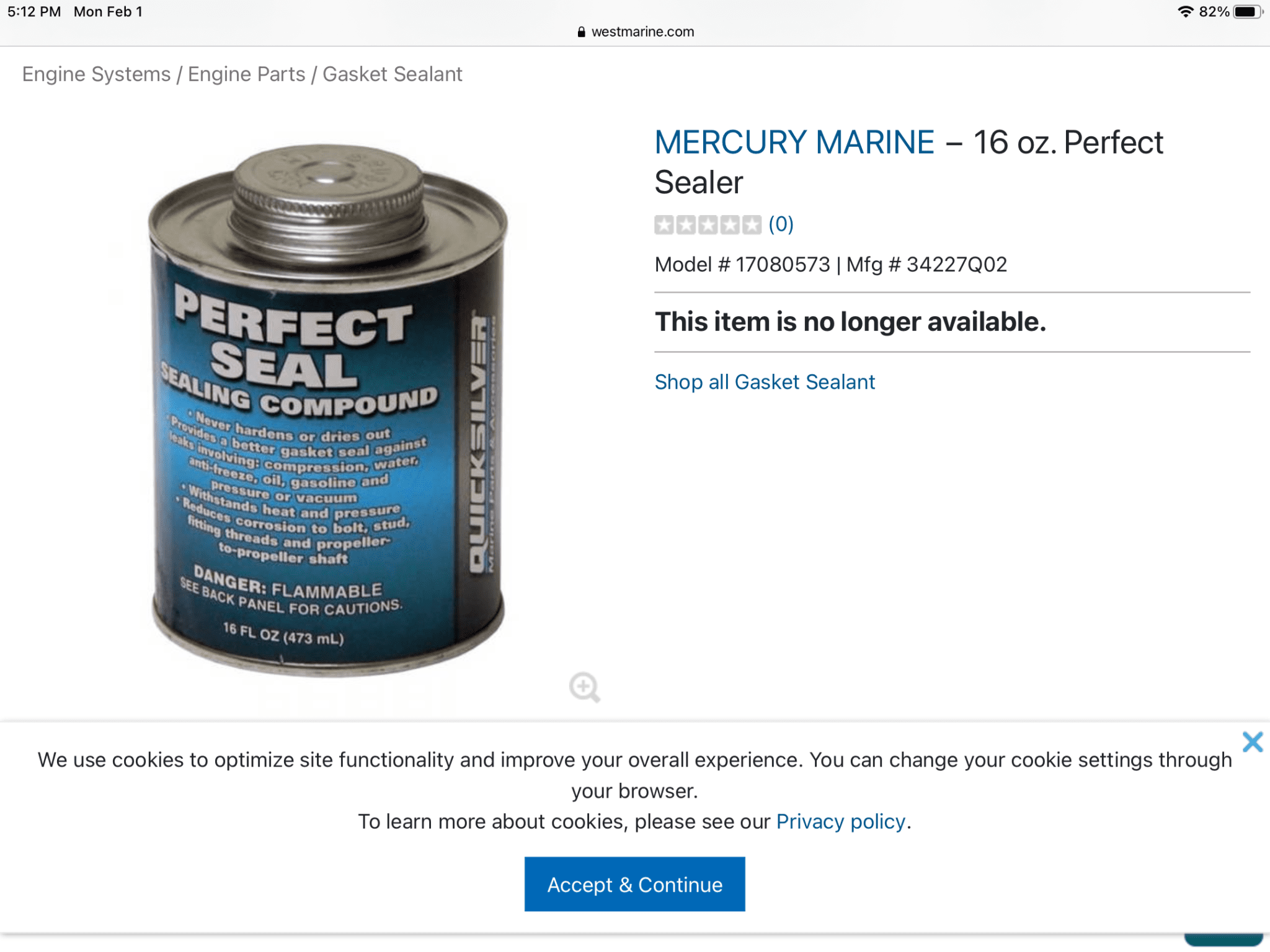

        Well gang, I hate to be the bearer of bad news but the Perfect Seal sealer according to all of the Mercury/Mercruiser websites I went to is also discontinued.
        If anyone has an extra can they would like to sell let me know.

          Will the perfect seal work on a exhaust housing gasket for the 7.5 omc or is the 3m scotch weld 847 ok to use Thanks Russ…
          Perfect Seal is fine for this application.
