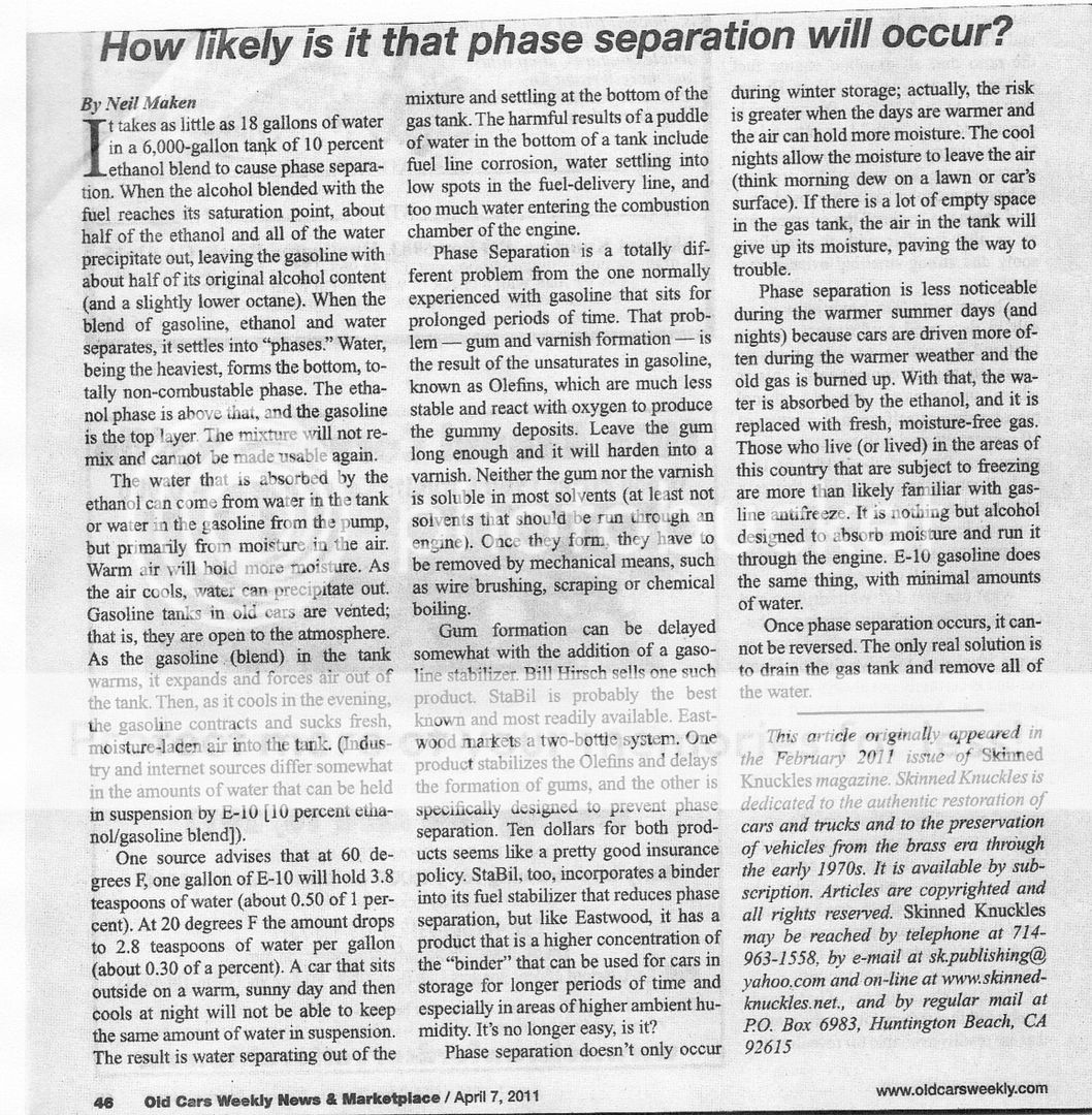

Here is the best article I’ve found on ethanol phase separation:
DaveNovember 21, 2016 at 2:43 am #47754Well Dave I’m probably going to regret posting this
but its actually takes over 5% of water at 60 degrees
before phase separation accrues in a 10% ethanol blended
fuel not the 3.8 tea spoons (0.50 of 1 %) as stated in
this article. This claim came from Sta Bil advertisements
but its not true and they no longer print it. He also states
"phase separation is less noticeable during the warmer
summer days " When your fuel pick up hits that goop in the
bottom of you tank your motor wont run no matter what the
outside temperature is. He probably meant to say less likely.
Words matter epically if that’s you job. Who ever wrote this
article was copying what others have written and never fact
checked it. None of these articles mention that for moisture
to enter a fuel the system it needs to be vented and most aren’t
today. The water comes from the air that enters the tank
through the vent. To prevent phase separation you stop air
from getting into the tank. If you cant seal the tank fill it up.
No room for air to enter.
No air – no water – no phase separation.
If you use only ethanol free fuel in a vented system you
will eventually end up with some water in the fuel. If
you live in a cold climate this water will freeze. This
was very common when I was a boy. Cars wouldn’t start
because the frozen water blocked the fuel to the carb.
The solution was to dump in a can of "Dry Gas" or
"Heat". These products were nothing more than some form of
alcohol.A "Boathouse Repair" is one thats done without having tools or the skills to do it properly.
November 22, 2016 at 12:17 am #47789I helped my next door neighbor a few years ago do a difficult emptying of an inaccessible gas tank under the floor of a late 1970’s Ski Nautique boat where they had 10% ethanol gas in it (a vented tank) over a Minnesota winter and phase separation occurred big time. In the spring, trying to start it, this stuff got pulled into gas lines fuel pump and carb, all of which we had to purge out. Thanks, Tubs, for pointing out inaccuracies in the article I posted that I was not aware of. Accurate or not, I’ve seen proof that phase separation does occur and can be a real pain to clean out, so best to err on the side of being overly careful to prevent it, and I agree – filling a vented tank to the top helps whether there is ethanol in the gas ornot – I do that with my I’O ski boat with ethanol-free gas and no stabilizer of any kind – has worked for the last 18 winters.
