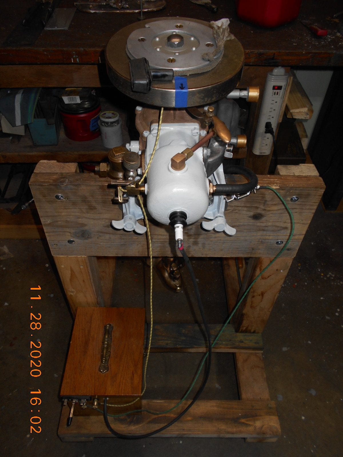

      I have no gas tank on the Centenarian Caille yet,
      but I remembered this motor has a primer cup,
      so I thought “why not”.
      It made the first, but brief signs of life in near
      60 or more years, since my uncle got in the 1960’s.
      I had to put more gas in the primer cup than I would
      have thought needed, before I got any action,
      but it’s showing great promise anyway.
      Question – What’s the proper fuel / oil ratio on this oldie?
      Where the arrow on the tape is (on the flywheel), indicates
      TDC. To get spark at TDC, the timer is in the traditional
      position as OMC magnetos.
      Q. – Would this be the proper position for the timer for starting
      per the Caille operation manual, which I’ don’t know if ti exist?
      While problematic with a rope start pulley, were these Caille Neptunes
      designed to run in reverse?
      DSCN9862

          Tubs, that’s a good idea, especially if you don’t have a primer cup.
          #223968
            I can smell the smoke from here!!!!
            I just squirt some mix in the spark plug hole…
