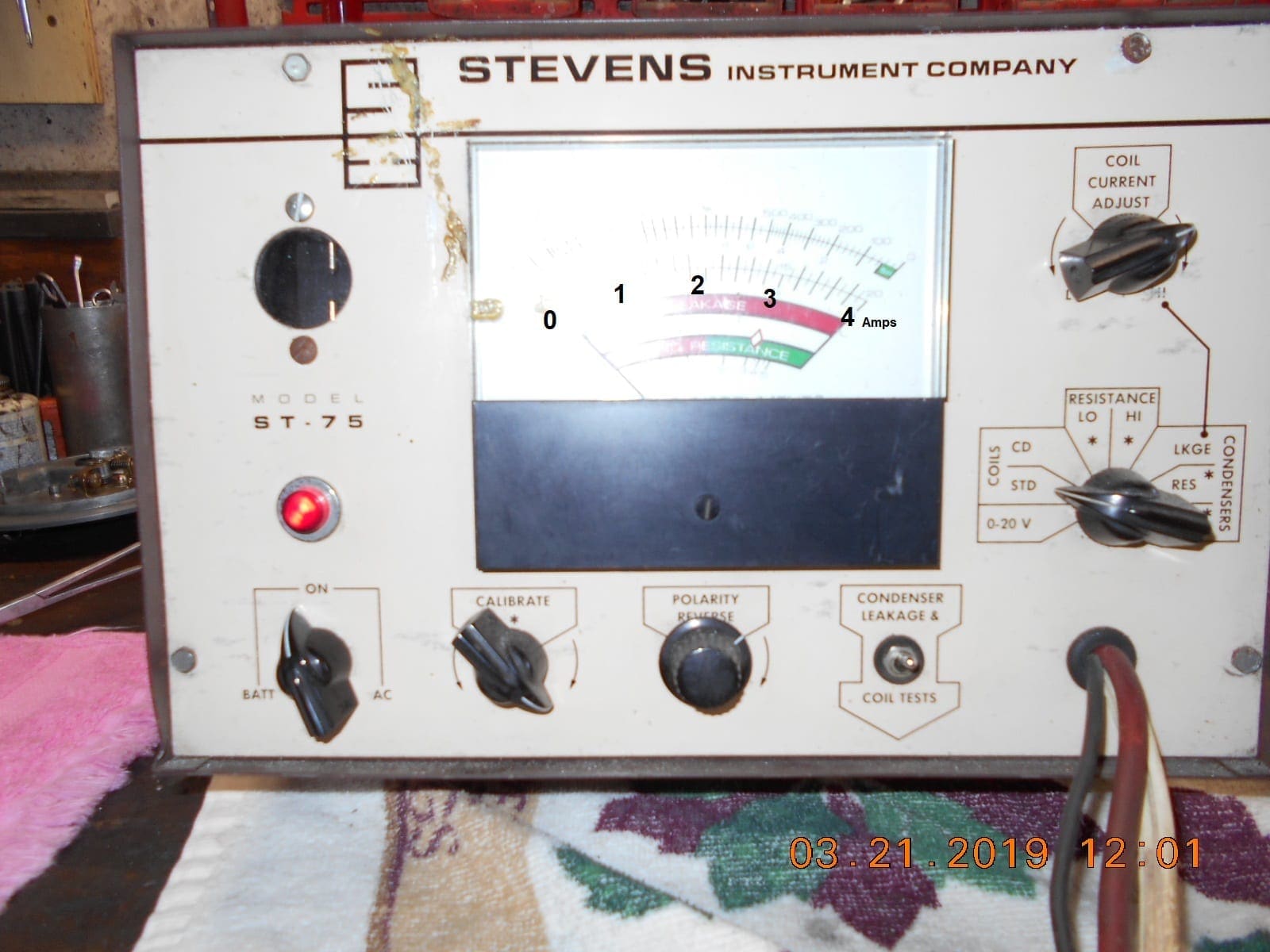

      I did some more testing (as suggested, I think) of the B&S coil on the Eismann lamination,
      laying it in the flywheel next to the magnets, in two different
      positions. Next, I tested the same coil back in it’s original lamination.
      Short story, even shorter, Poor performance with the B&S coil on the Eismann lamination.
      Three short test videos, and pictures that coincide.
      Perhaps I’ll try a pony coil next 🙁
      Tester
      https://youtu.be/rcqcjAu1uZE
      https://youtu.be/4nest4uhmIM
      https://youtu.be/S3iLDakUEn0

              I should have re-emphasized that previous test with the B&S coil
              on the Eisemann lamination, testing while Not in the flywheel, were equally,
              if not more, disappointing.
              It was just an experiment to see what impact the flywheel magnets
              might have on the magnetic field and testing results.
              Most likely it’s the configuration of the B&S lamination specifically designed
              for it’s coil, that makes the magic happen at lower amps on the Steven’s tester.
