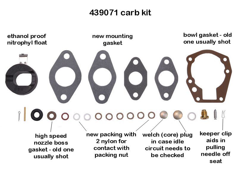

      I need a carburator repair kit for a 1954 Johnson 10hp(QD-15). Any help would be appreciated.

        OEM  kits from  the dealer      is preferred  !     some dealer kits DO NOT HAVEA FLOAT so check what you buy !!!
        some  China  kits   have orange goo gasket known to melt away and  needle seats have a wrong thread.
        unless something is broken or missing a good cleaning with carb cleaner and air blasting usually does it. adjust  the float level with the carb body,  don’t spray carb cleaner on the float. use safety glasses
        the float if not to bad can be sanded a bit  and  “painted” over with crazy glue and dried.  … don’t smell the fumes and protect eyes and lungs.
        when done do a blow test … air goes in right side up  and air DOES NOT go in  upside down. This test checks the  float and needle seating properly

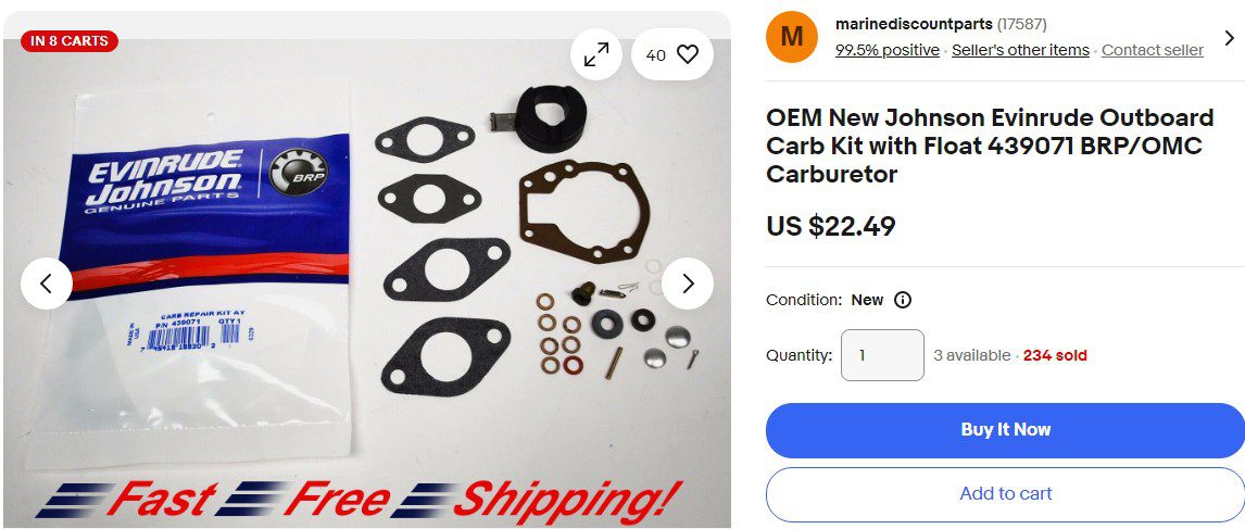

          Some OEM kits for your ’54 on ebay right now for $22.49 and Free shipping – https://shorturl.at/tIIBV
          ebay-carb-kit
          carb-kit-439071

            Steve.. Amazing  price.!!   China is in trouble 🙂
            of course in  Ebay Canada  80$  incl shipping and I suspect 15%
            New Genuine OEM Evinrude Johnson BRP 0439071 Carburetor Kit 439071 OMC Carb | eBay
