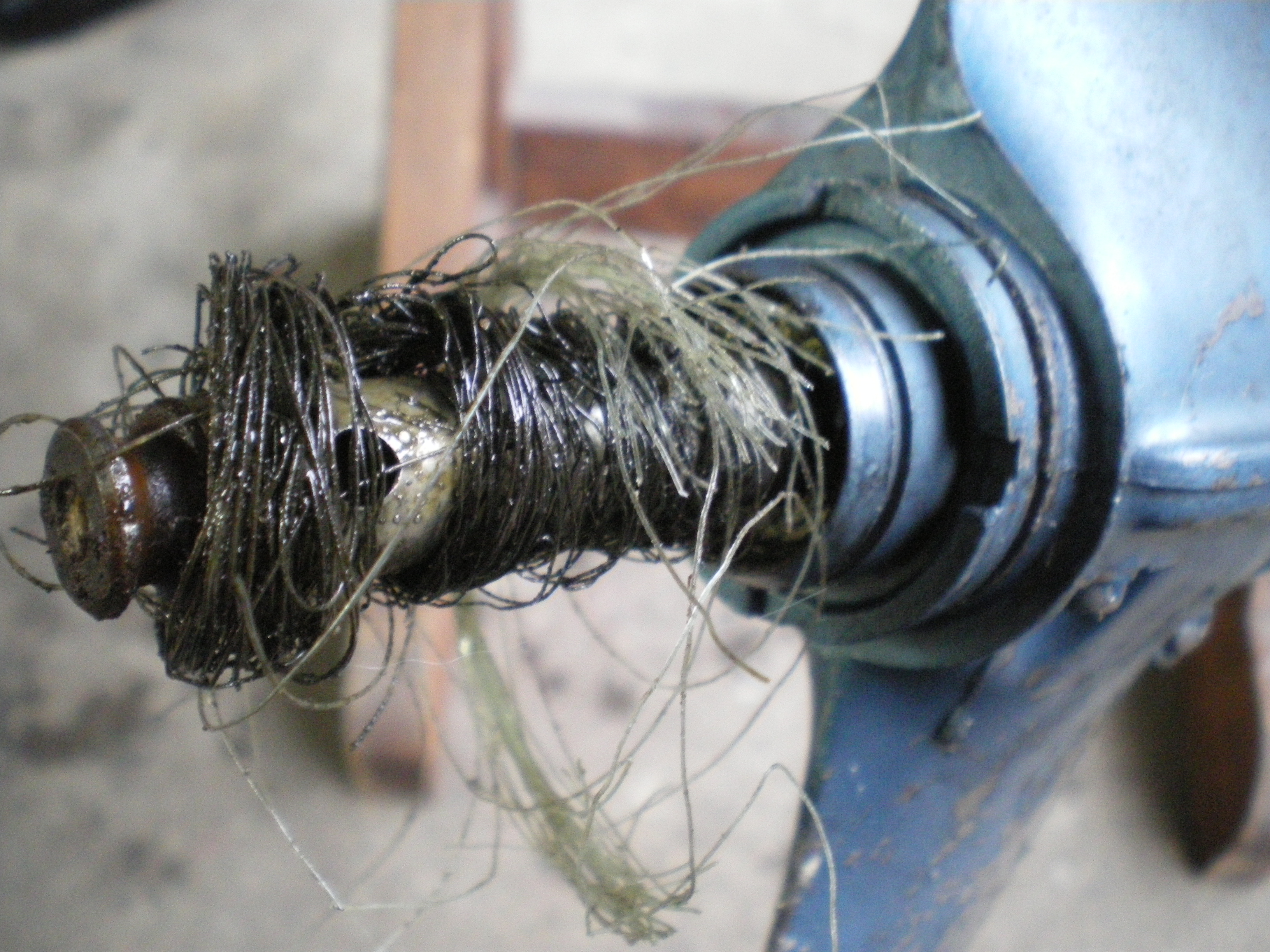

            It might have fishing line wrapped around the prop shaft and it turns into a big knot when going in reverse. Pull the prop and have a look before doing anything drastic.

              Ah yes, how often we don’t think of the simple stuff.
              #57846
              fleetwin
                Never overlook the simple stuff, a lesson I must keep relearning!
