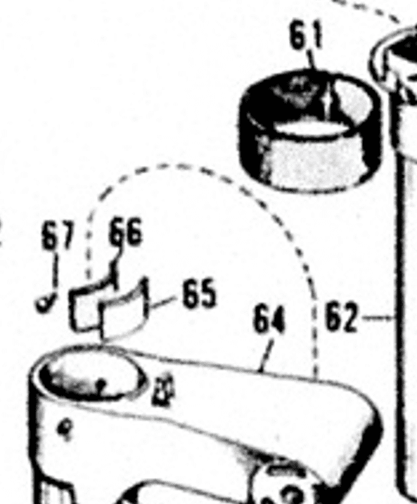

      Somehow I lost part# 67 on the attached drawing. Part# 303696.
      It’s the pin that puts tension on the collar plate and spacer when the collar screw is tightened.
      Does anyone have a parts motor that they would be willing to part with this pin?
      Or, some really good measurements and I can hack up an aluminum bolt into a correct sized pin? Nope, no lathe. Just a grinding wheel, some hand files and a sincere desire to succeed! Lol.

          You are mistaken, that is not its purpose.  It simply keeps the liner from rotating when steering back and forth.  Any ol’ pin, rivet, screw, whatever, will do.

            So the small end of the pin fits into the recessed hole opposite the tiny ‘tit’ hole?
            The drawing led me to a different conclusion, (and the fact that I never even laid eyes on the dang thing, for all I know it was never even there…).

              Yeah, I recon.  The pin head will be in the hole in the split of the liner.  The other hole in the liner will align with the “tit” hole (grease / zerk fitting) to allow grease to pass through to the pivot pin.  Interesting description, tit.
