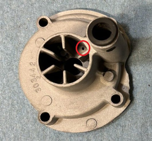

                  mic57
                    When you revisit the water pump make sure that the small hole in the pump housing near the driveshaft is clear. If this passage is clogged the pump will not operate effectively.
                    water-pump
                    #298036
                      agree.  drill test on drive shaft  seems to pump tons of water  so LU side should be ok.
                      Time to pull welsh plugs  and fish out any crud  if nothing else works… but before pulling the plugs….. try a desalting solution to fill all  cooling zones  with  the PH upside down for  a day or 2  .  30% warm vinegar should help or a commercial product .
                      a small endoscope probe  could shed some light 🙂 on the problem
                      #298037
                        water-pump
                        Excellent advice!!
