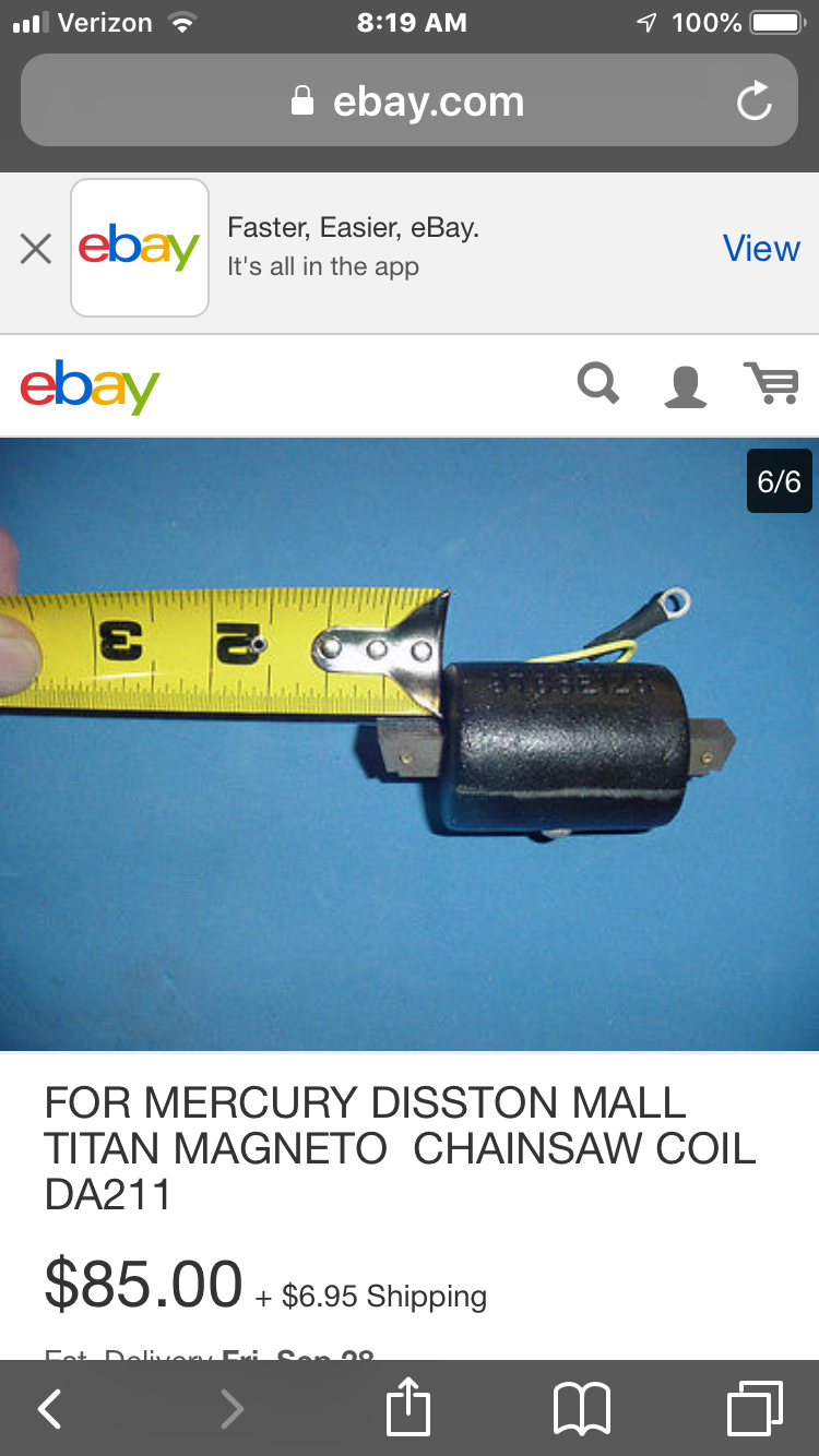

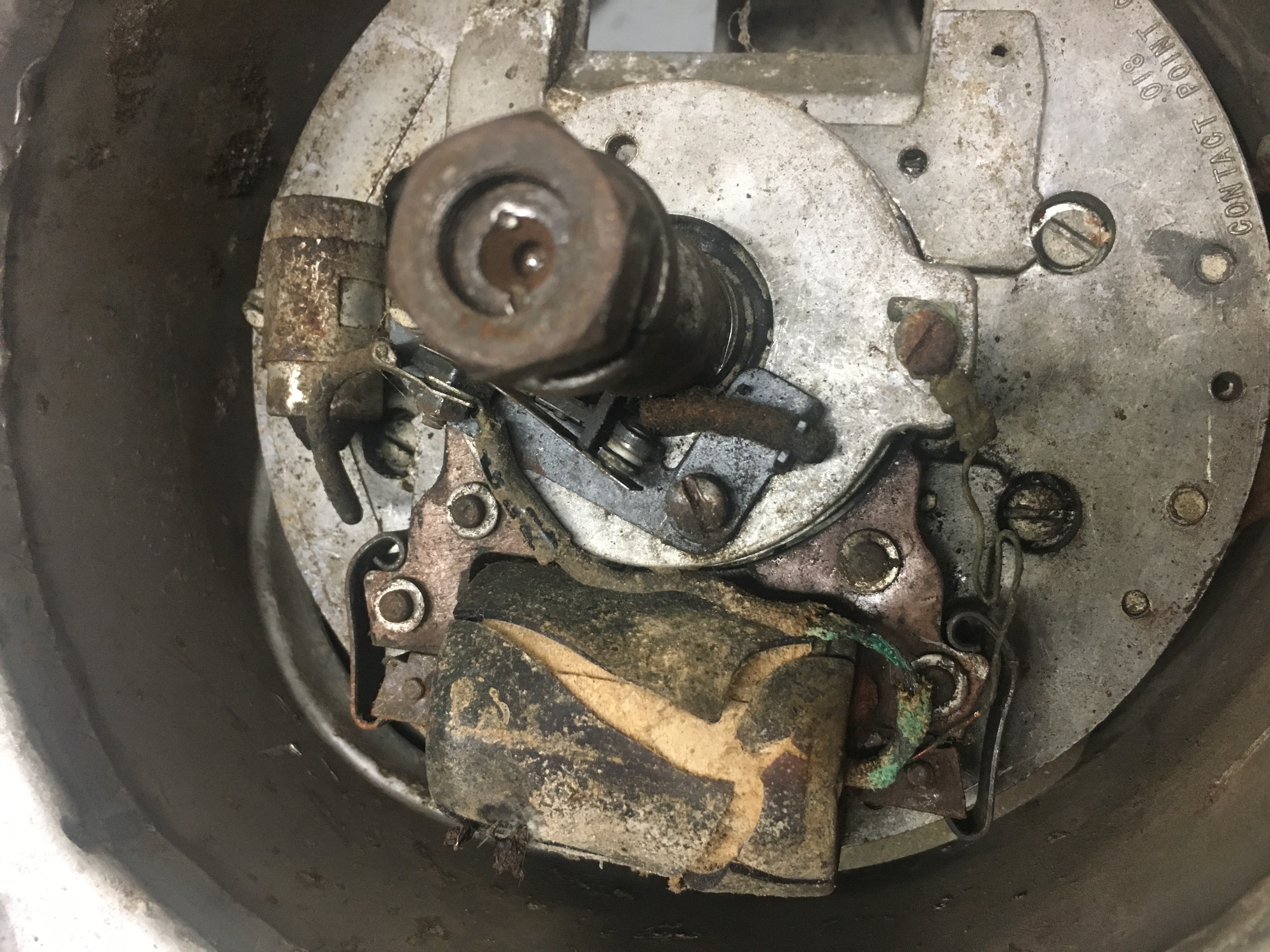

              No spark looks like I need coil points and condenser anyone know where I can find these parts?
              #83315
                I have heard that these will work. Haven’t personally tried it. Yeah, I know, you only need one.
                https://www.ebay.com/itm/FOR-MERCURY-DI … 1911655161
                #83355
                sljohnson
                  That looks like it will work. Thanks!
                  #83357
                    He will sell you just one.
                    https://www.ebay.com/itm/DISSTON-MERCUR … XQ97RRHTLJ
                    #83379
                    squierka39
                      Watch when you put the new ones in. The old one is backwards. The little notch in the laminates is for the spring clip to fit into.
