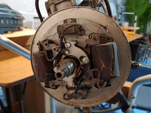

        I have included a picture of the Magneto showing the coils and wires I am looking for.

          Those are Bendix coils. Lee Holland ran the Chris Craft Outboard website. Unfortunately, he is no longer involved in the hobby. You can repurpose a 2A016 or a 4A032 coil to work. These coils are also known as the single and double output “military” coils.

            Thanks Wayne! I passed on your information to my buddy that is helping me get this classic motor up and running again.
