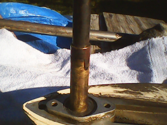

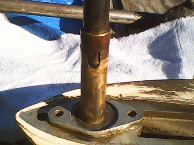

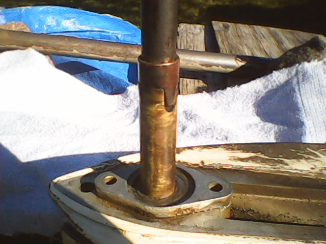

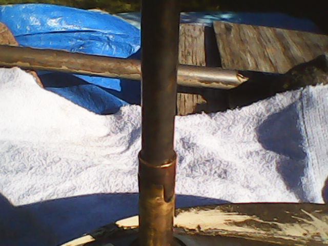

      I have a Clinton J7 5 hp model 10-13-7-0-4-5 outboard that I’m working on and have a question about the driveshaft/water pump area.I ordered a impeller and it fits on the driveshaft just fine but when I get down towards where it sits in the housing there is a 2 piece brass bushing on the driveshaft in the way.I reamed out the impeller to make it fit and ruined it by removing the bushing inside the impeller.I ordered another impeller but I don’t want to ruin this one.Should the 2 piece bushing be there? I can attach some photos to clarify.
      Thanks,Scotty1960.

        Not sure but thinking that brass sleeve is the hub of the previous impeller and should be removed.

        tinkererdude1960
          I removed the sleeve.Had to heat the small piece I think it was brazed on.Now the impeller will fit.Just have to drill a hole for the impeller pin.Thanks for the advice!
