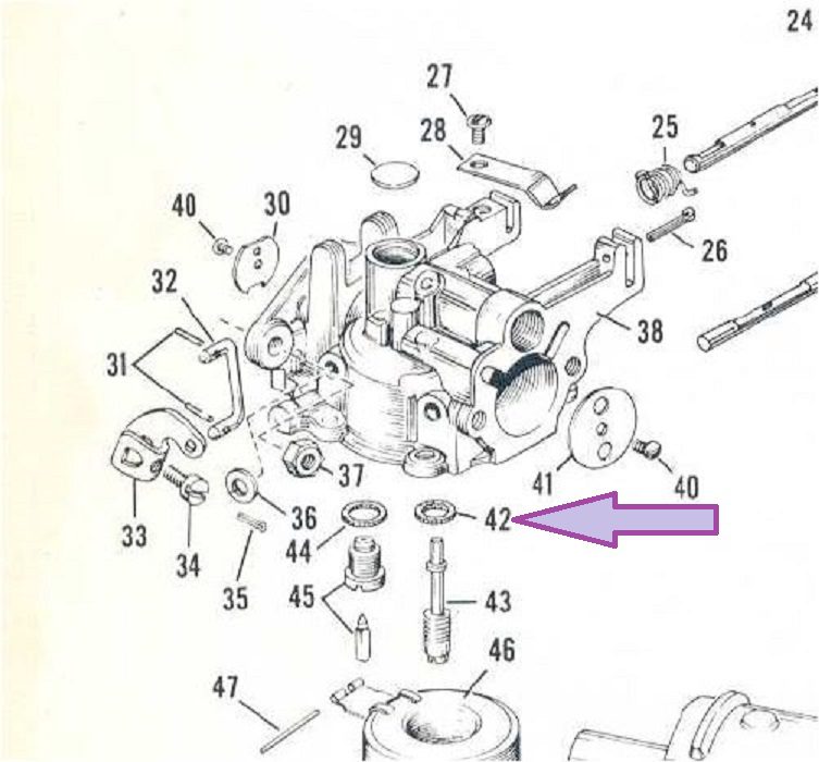

            Is the gasket on the brass pickup in the center of the carb on and the correct size.
            This is the 302984 nozzle gasket Dave is referring to.
            1956-AD-Carb
            #245862
            Boonie
              I will pull it apart tomorrow and try to post a picture. I think we’re on to something. Thanks guys
