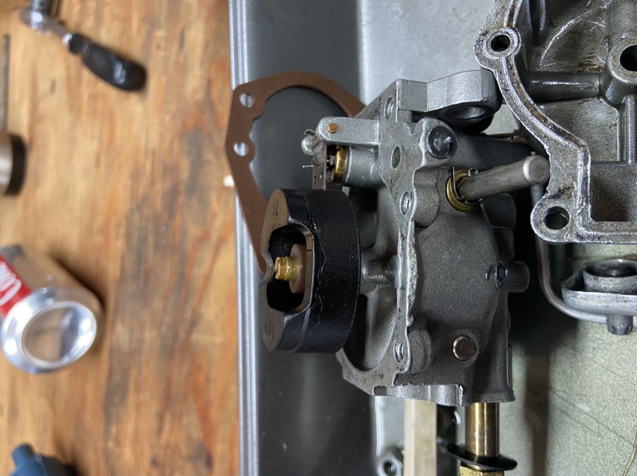

                    Is this float correct?
                    04DBF76A-AE9E-488E-B276-7D42D753744B
                    • This reply was modified 4 years, 6 months ago by Mumbles.

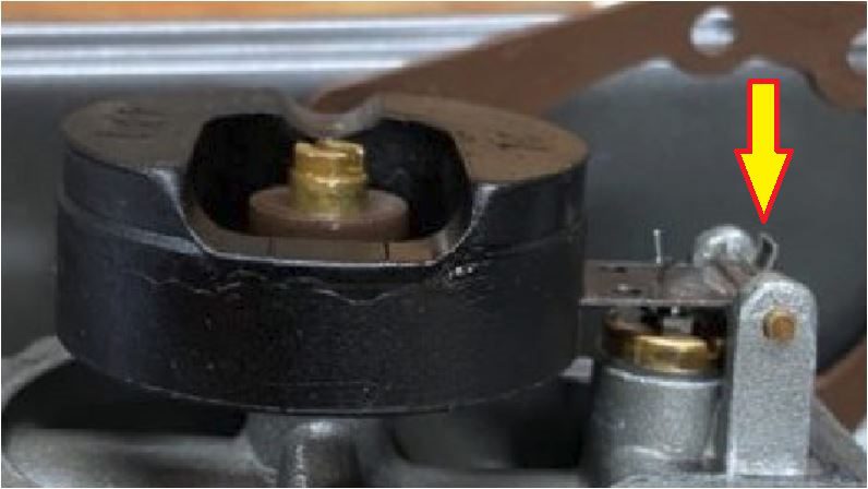

                    Your float is installed upside down.
                    The tab, for setting float drop, should be pointing towards the body of the carb. The cutouts in the float should face upwards, away from the fuel in the bowl. The way it is in your photo, the float won’t have enough buoyancy to close the float valve and the motor will flood.

                      Sorry about the float picture. That pic is opposite of the way it was installed
                      Just saw this post. So the float was installed correctly?
                      #246356
                      Boonie
                        Yes mumbles, the float was correct. The picture post was an error. All new ignition parts and I’ll try it again. I’m thinking the spark was to weak or intermittent.
