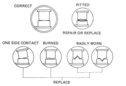

                  A bad capacitor or one with the wrong uF rating will cause metal transfer across the contacts, better known as arcing and pitting, along with poor spark at the plug. Too high a uF rating, metal transfers from one contact to the other. Too low a rating, metal transfers the opposite way.
                  Points-Inspection
