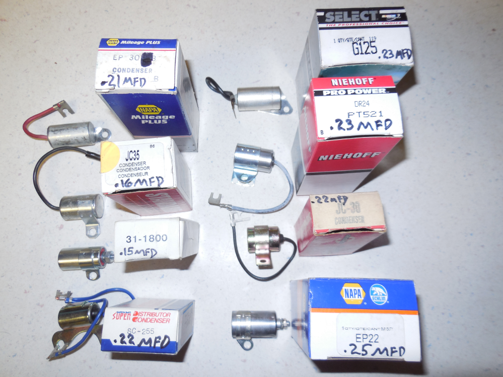

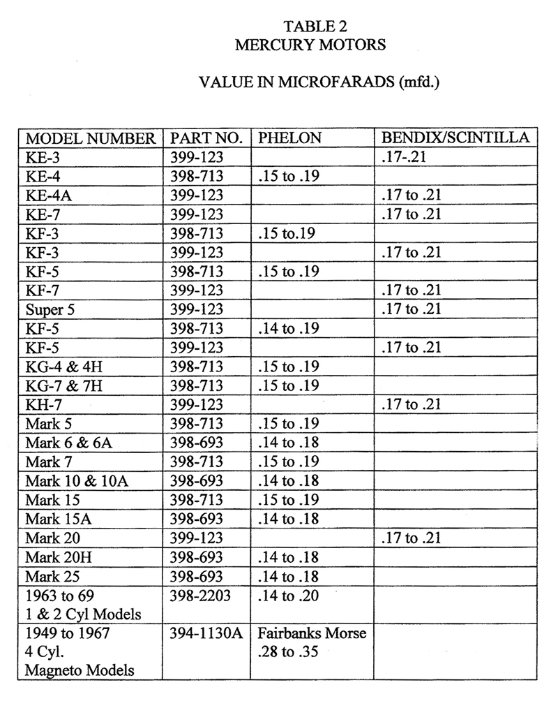

        Here’s a listing for Merc mags using the Bendix Scintilla and Phelon systems and also a photo of different automotive caps. The mounts on the Ford ones at the top might allow easier installation in a tight place.

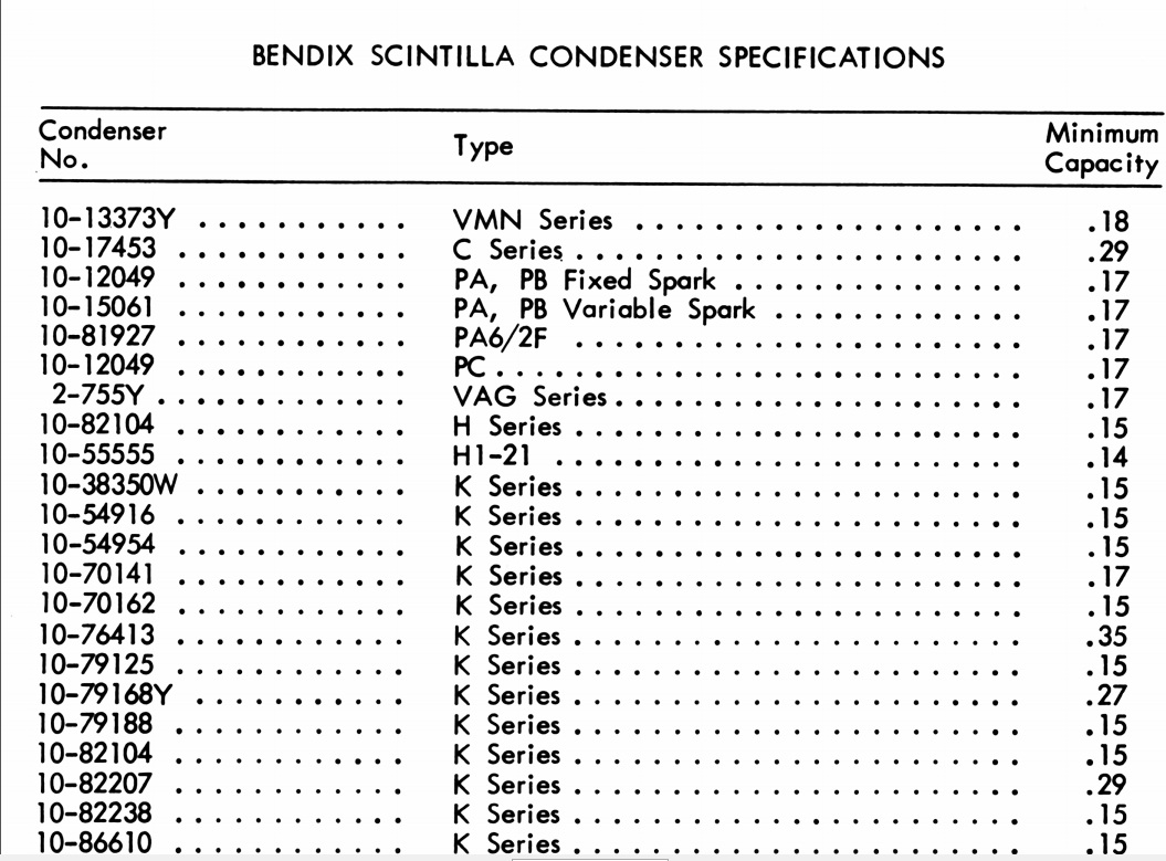

        #56541
          Mumbles, using the parts manual you sent, I found the condenser number,
          10-82104, and was able to reference to the info on
          this data, showing I need a .15 mfd condenser.
