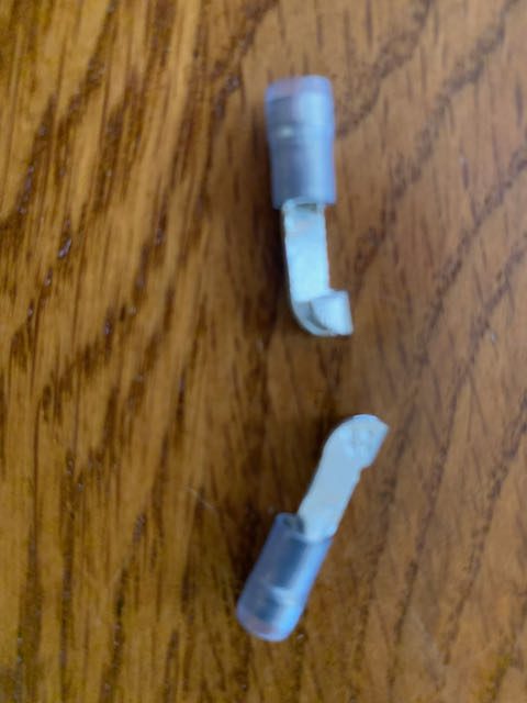

That is a knife blade connector & it should have a insulator big enough to slide over the exposed metal like a small rubber hose. I forget where I saw this type of disconnect, I think maybe marine, old V.W. beetle or Motorcycles. What are you using it for?
May 9, 2023 at 7:36 pm #276099That is a knife blade connector & it should have a insulator big enough to slide over the exposed metal like a small rubber hose. I forget where I saw this type of disconnect, I think maybe marine, old V.W. beetle or Motorcycles. What are you using it for?
Thanks Jeff. I tried all kinds of ways to find the name. I have a mag plate for a Mark 25 that has two wires with this type of connector for a kill switch.
May 9, 2023 at 10:07 pm #276108Some of the 50’s OMC classics also use a similar knife blade connector for the kill switch leads.
1959 Johnson QD-20“Every 20 minute job is only a broken bolt away from a 3-day project.”
"Every time you remove a broken or seized bolt an angel gets his wings."May 10, 2023 at 3:21 pm #2761301960’s OMC electric shift gearcase leads. https://www.marineengine.com/newparts/part_details.php?pnum=OMC0379645
May 10, 2023 at 11:05 pm #276142Kerry,
You are right! I remember my OMC Dual Deluxe 17′ tri-hull boat had the same knife connectors in the electric shift gearcases, We were into them many times replacing the electric clutches & the wrapping springs. It was a 1962 model with two 88hp 2stroke V-4 I-O drives & E shift. They had magnetic emergy that would pull the clutches on tapered hubs to engauge. No klunk when shifting.
May 11, 2023 at 1:27 am #276146I could be wrong, but I think those connectors were called “Packard connectors”
May 11, 2023 at 5:52 am #276147I always knew them as knife connectors. They may also have a brand name; I don’t know. Kind of like tissues and Kleenex, maybe.
In the OMC world, I have used the connectors shown in your picture, by taking the plastic insulation off of them. That allows them to fit inside OMC’s rubber insulating sleeves.
