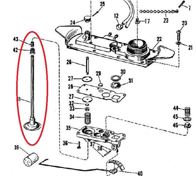

              All my QD manuals and marineengine  show a six gallon  375774 tank for the ten horse motors which is the same one used for the eighteens.  The ’55 QD-16 parts manual also shows a straight foot valve in the tank while the foot valve in the small tanks was bent to fit.  Seems like it was only the 5.5 and 7.5 horse motors which came with the small tank. Either way, a quart of oil in a full correct tank for a motor will give either a 16:1 or a 24:1 fuel mix.  This only works for US gallons and not the old Imperial gallons.
              955-QD-16-Foot-Valve-1
