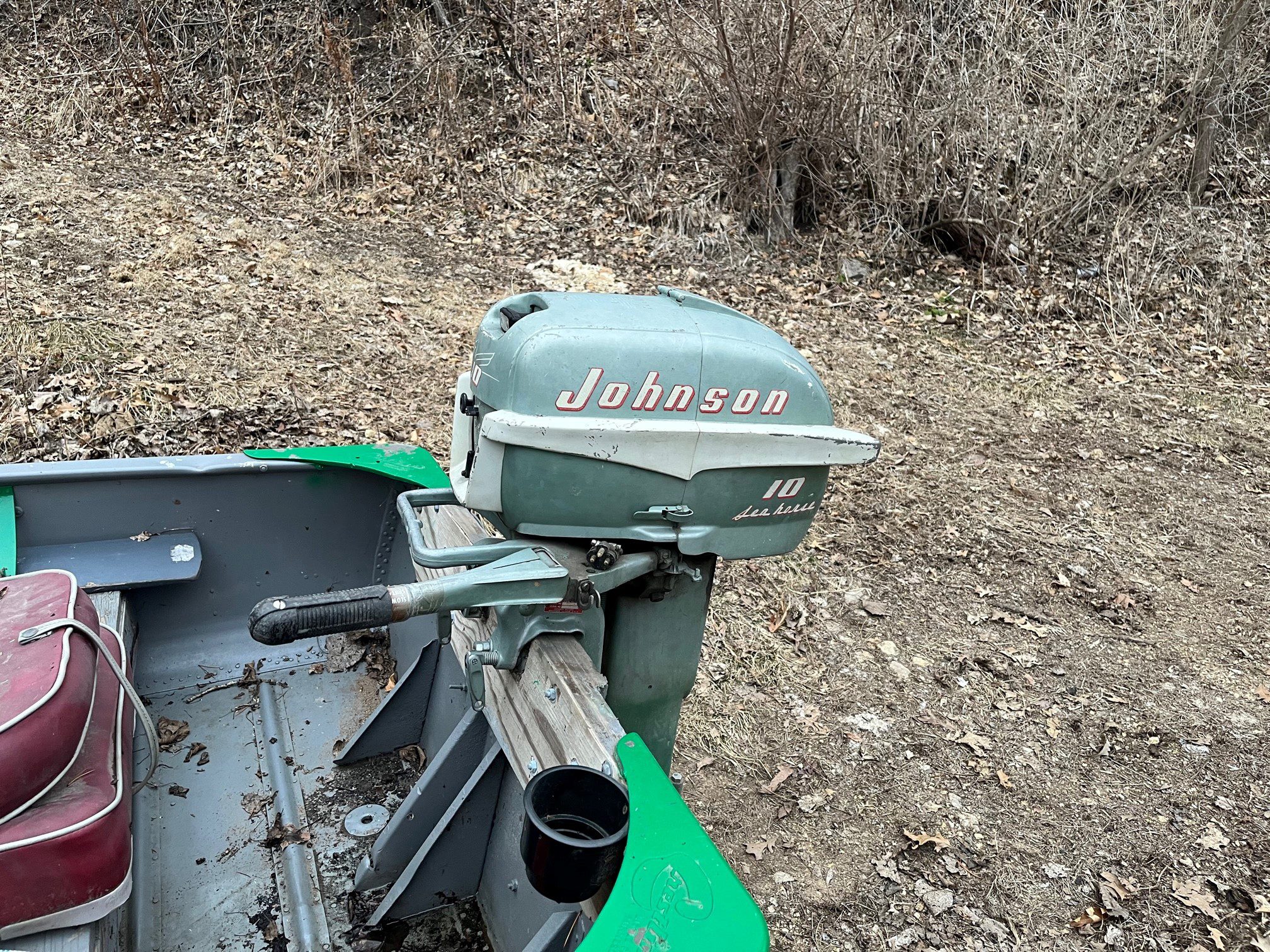

                      Here is a picture of the new to me Johnson Sea Horse 10. Thanks for all the replies. I believe that I will mix the first tank of gas at the 16:1 ratio and see how it runs first. The motor overall looks to be in great shape for its age.
                      It will be a while before I get to use it. Here in Wisconsin it was snowing today and the next weeks weather still looks like cold and rain.
