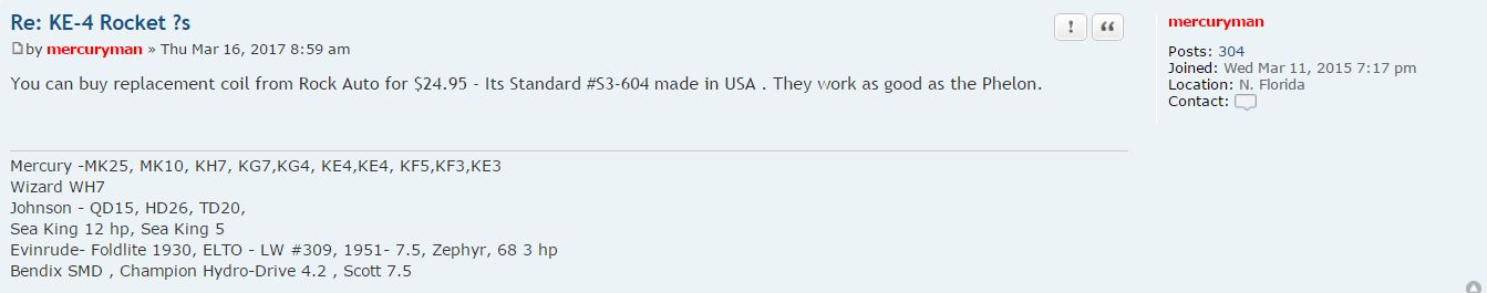

          In another thread Mercuryman pointed out that Standard has a Phelon-equivalent coil for $24.95. I thought I’d mention it here as I was not aware of it. Standard #S3-604
