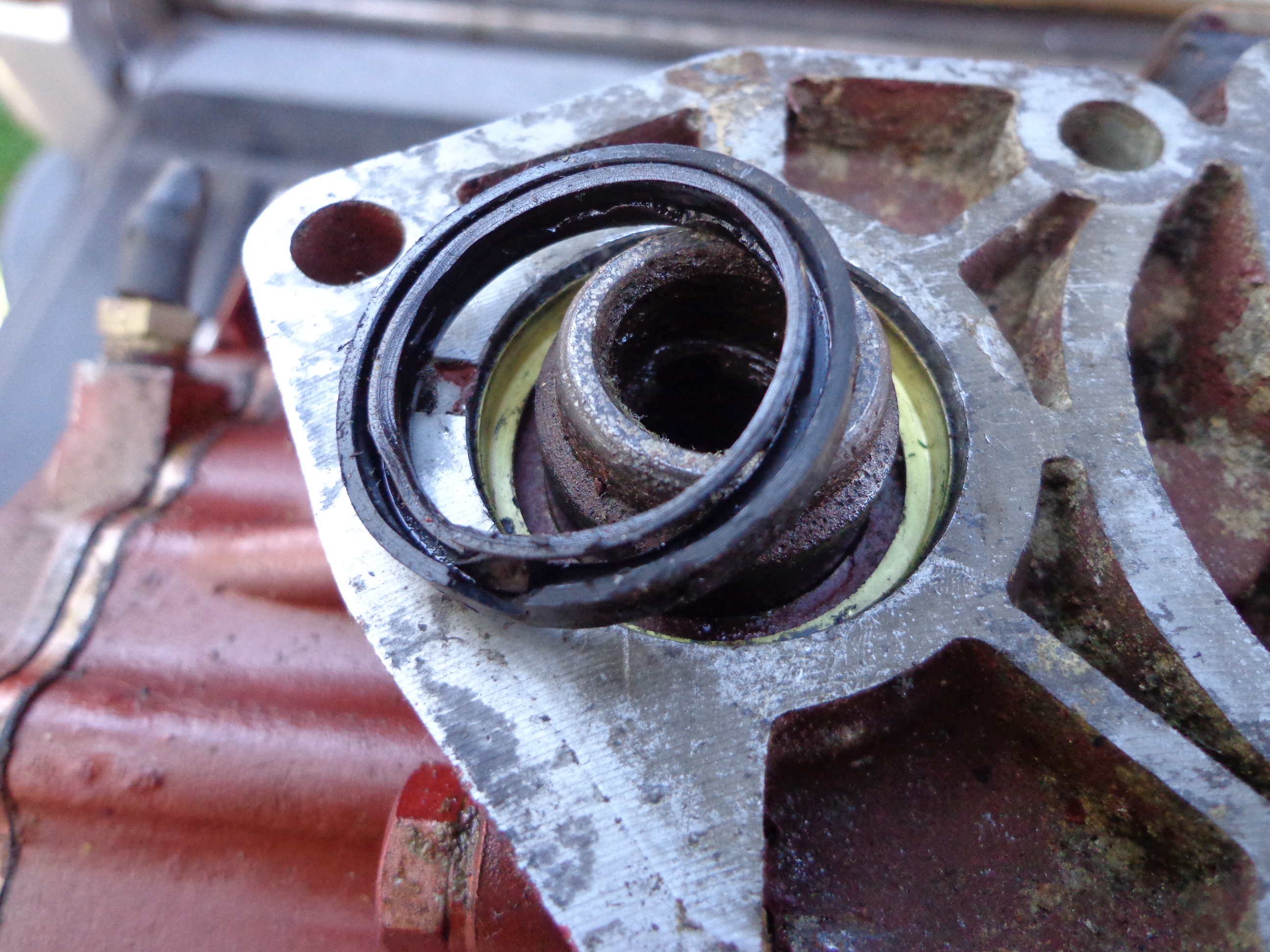

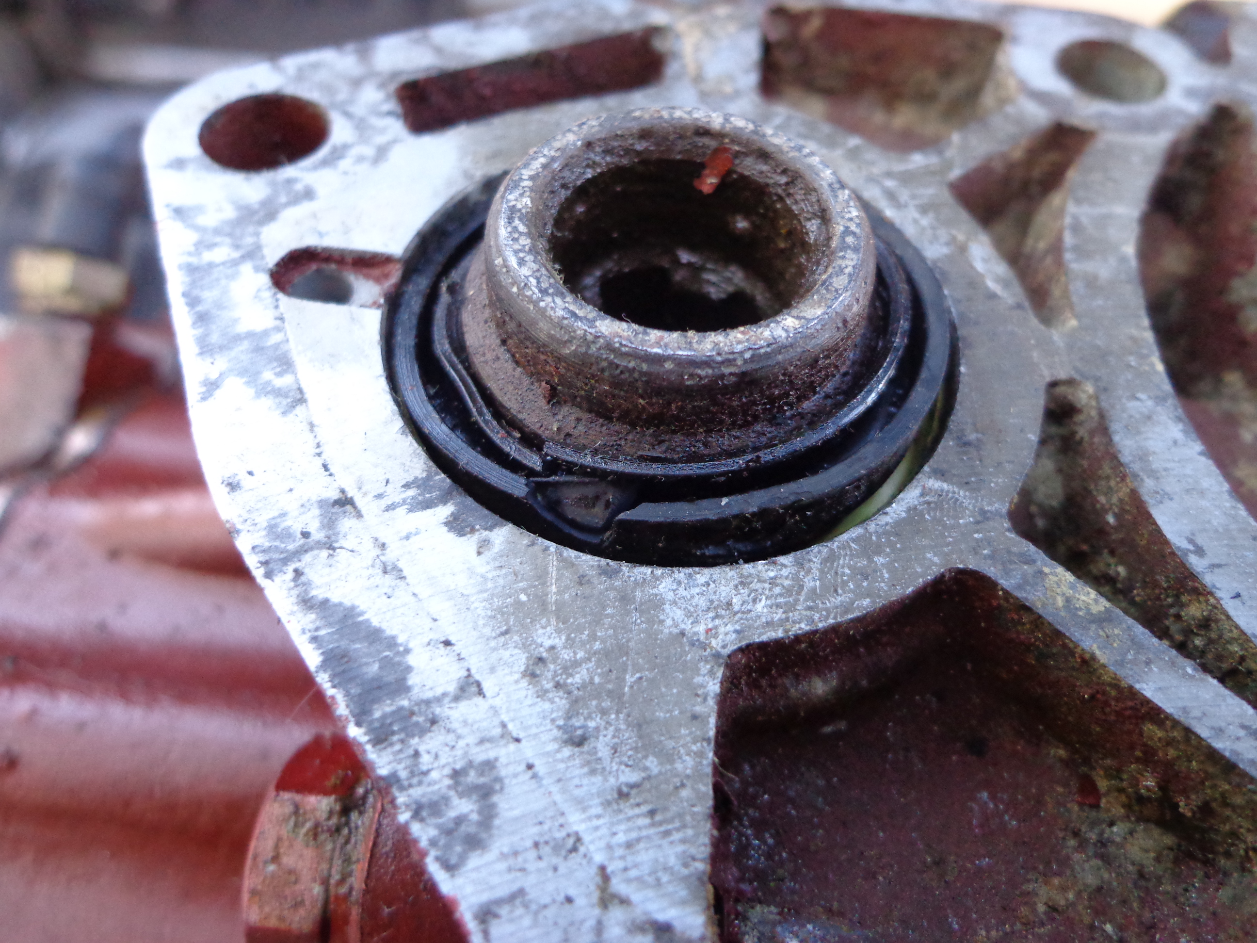

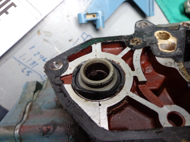

            1957evinrude
              I was told by members here if u own a 1956 15 hp evinrude or Johnson and 1956 12 hp gale its best to replace the bottom crank seals as they are prone to failure
              #64932
                If the top seal is gone, the bottom one will probably need replacing to at the same time, especially if the motor has lip style seals instead of O rings.

                  1957evinrude
                    I replaced the bottom seals on my 56 15 and 12 hp engines. Its not difficult at all.
