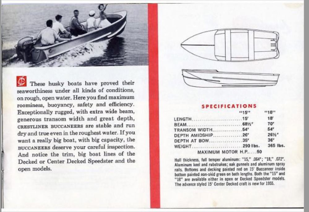

      I have 1955 Crestliner Buccaneer (with ’55 RD-17 Johnson) and I’m trying to get a new trailer for it. The original one was a handmade contraption that has seen better days.
      I’m doing all the measurements but having a hard time determining the deadrise dimensions of the hull.
      Has anyone ever taken such dimensions or have a resource that gives detailed drawings of the various Crestliner models?

        The red boat
          thank you.
          yes I had that but it doesn’t give any detailed dimensions or angles of things.
          I do appreciate your response tho!
