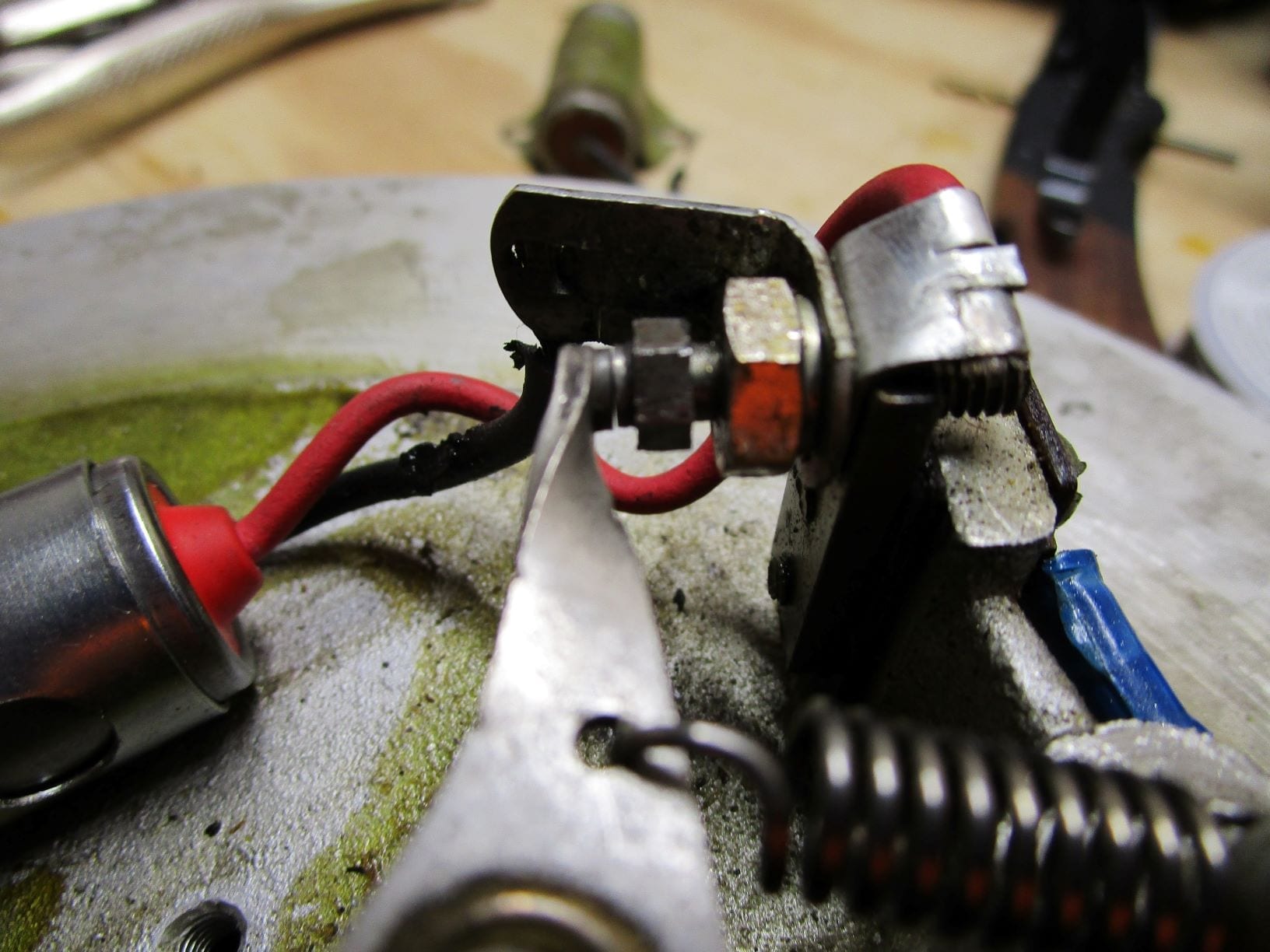

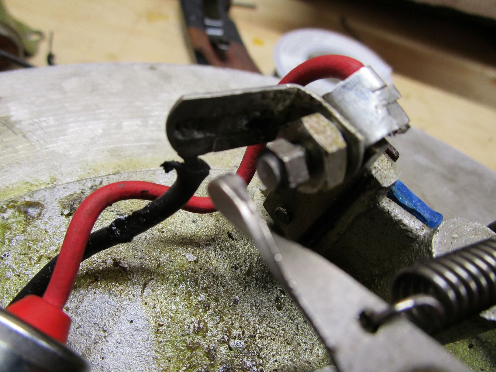

      Can I pick these condensers up from auto parts stores ? If so what do I ask for ? Just one rated at .30 ? Sorry for my ignorance on this stuff .. Trying to find parts have been fruitless . Seems most online stores parts list only go back around 1957 or so . I would like to find points if there out there . Do you just replace the contacts or the whole arm ?
      IMG_0864
      IMG_0863
