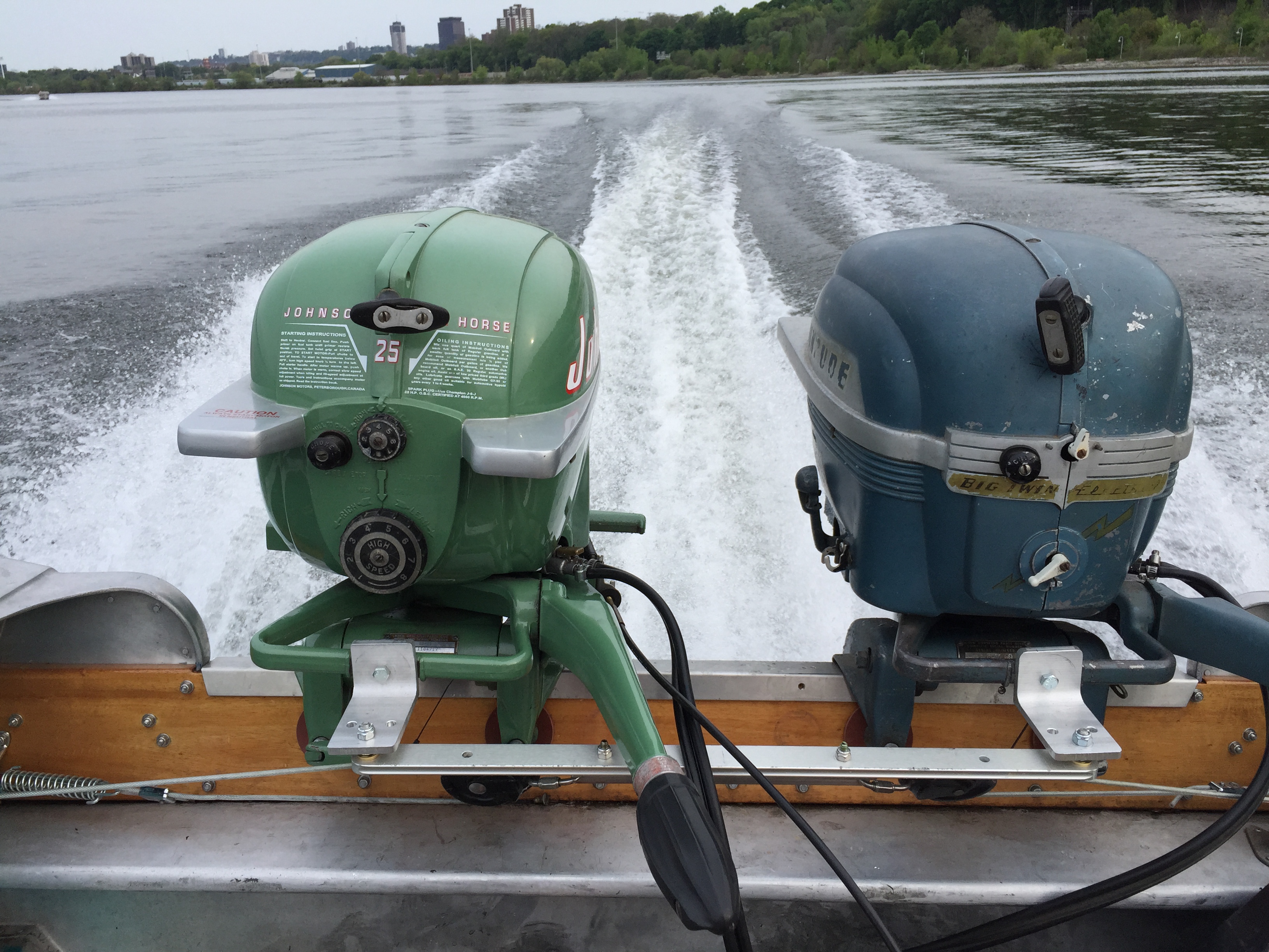

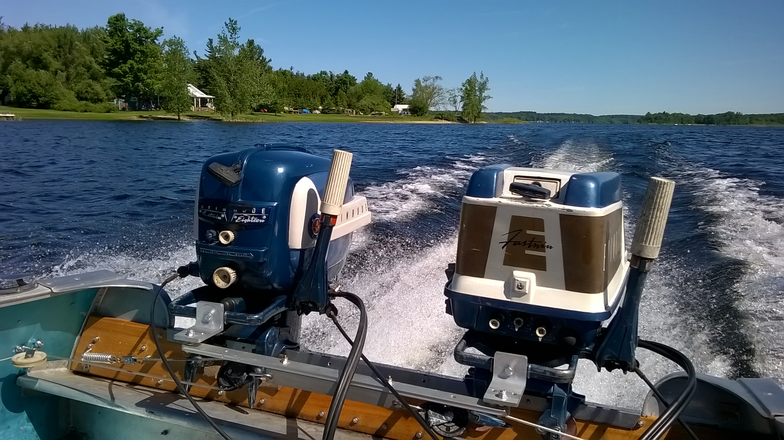

              #31353
              wbeaton
                You don’t need counter rotation for motors this small. I helped a friend setup twin 18 hp and 25 hp OMC’s on his 14′ Feather Craft Hawk. Both sets of motors performed beautifully back there. I’m putting a pair of 1962 Johnson 40’s on my cabin cruiser. Twins are every mans dream ๐Ÿ˜‰
                Wayne
                Upper Canada Chapter
                uccaomci.com
                #31373
                1946zephyr
                  Nice sets of twins ๐Ÿ˜‰

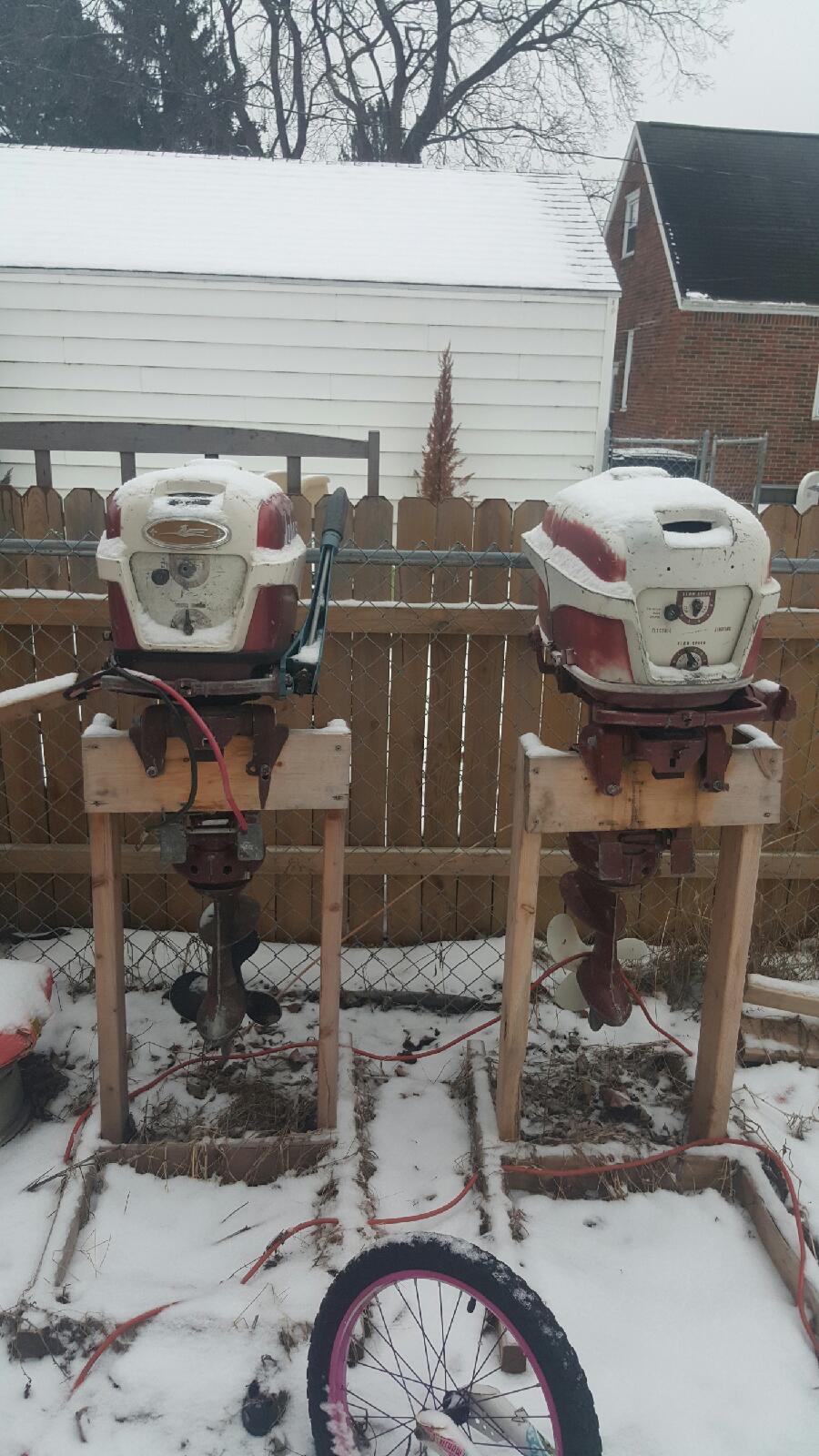

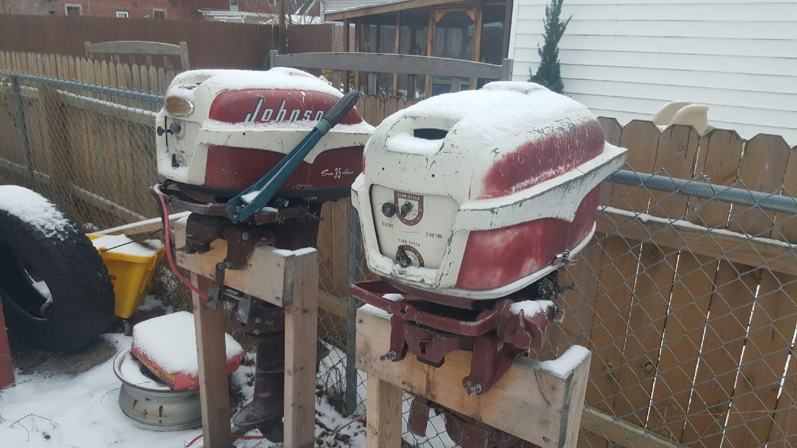

                      #32280
                      instigator
                        The final pc’s of the puzzle.
                        Pick these up next weekend.
                        ‘1957 35’s.
