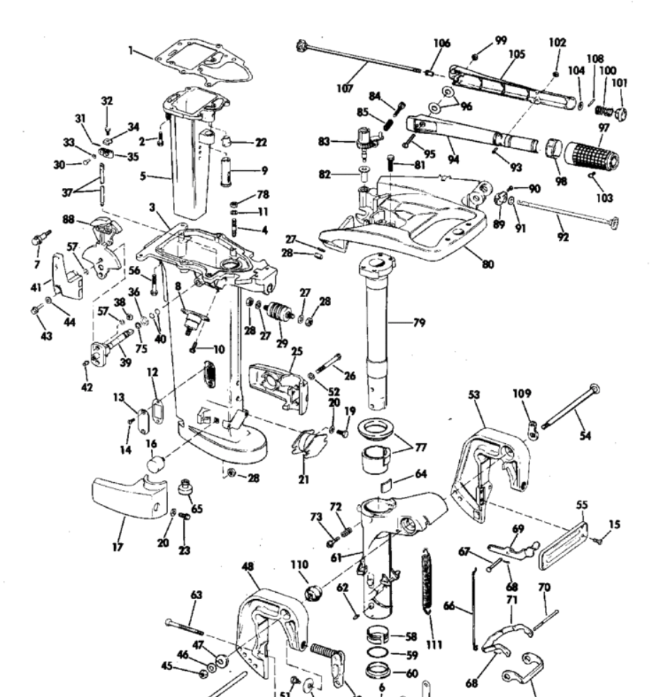

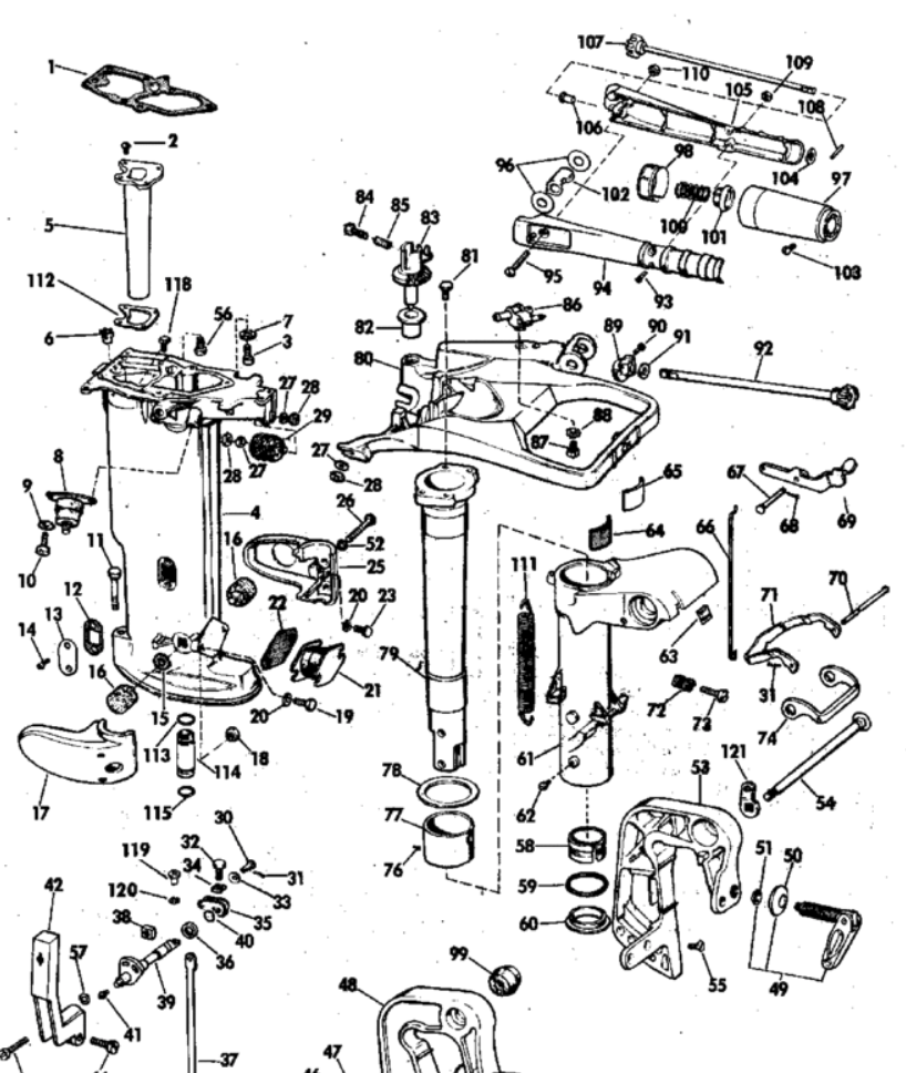

The easiest way to judge "swap ability" is to compare the powerhead to exhaust housing gaskets on the two outboards. The ’73 20 horse takes a 0314421 gasket and the ’81 25 horse takes a 0330621. . . 🙄
