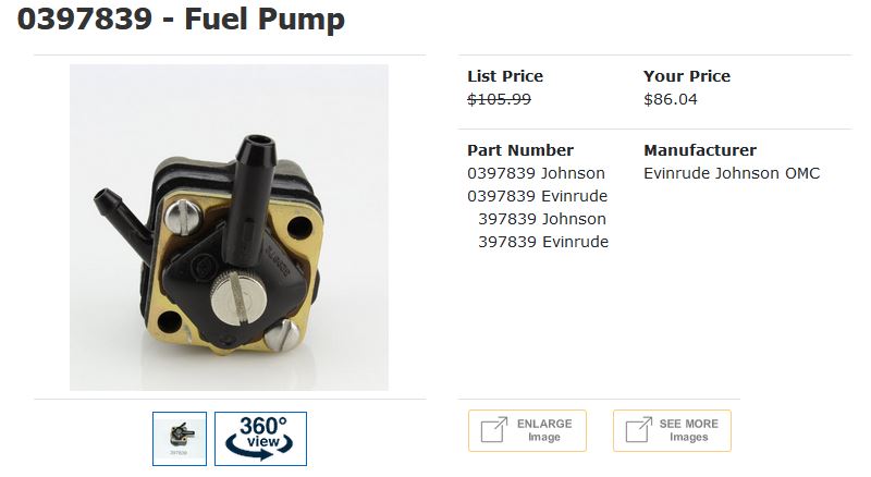

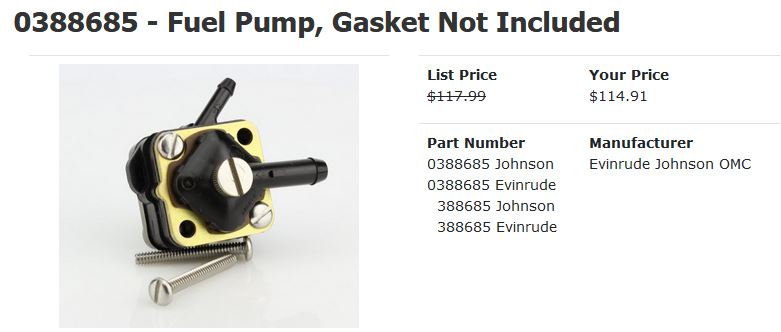

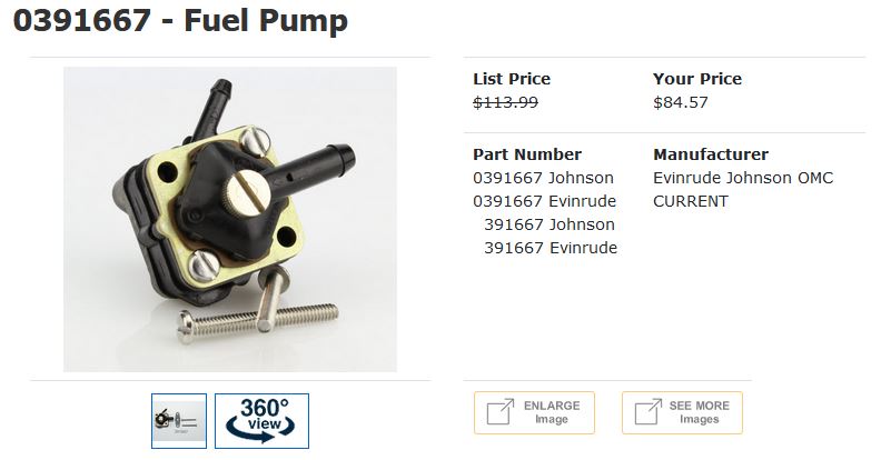

      I started looking on Marineengine for a new fuel pump and see that there are (at least!) three models with essentially the same appearance. Can someone tell me what the difference(s) might be?
      OMC Part number 0388685, 0397839, 0391667.

      #249754
        some have thicker bases but I think they are basically the same …
        I found some at $6.99 (no longer available from DEALPEAK folks) … I know OEM is better but…
        #249756
          position of bolts on 2 of them the other the position of hoses.
          #249757
            Probably the same pump mechanically but the inlets and outlets are clocked differently. The beauty about the square pumps is you can locate both of them wherever you want as long as the internals are correct.
