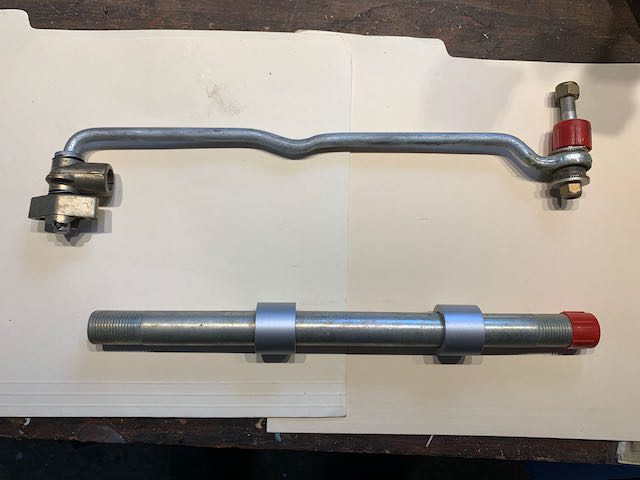

      It’s almost midwinter and cabin fever has me obsessing about another kooky project.  I want to run a pair of Mark 25’s on an Aluma Craft Flying D.  This idea has been stirring for years.  I bought this attachment kit long ago, and I think it’s meant for attaching dual Mark 25’s, but I don’t have directions.  Looks like it’s for a Ride Guide cable.  I think the tube is meant to replace a tilt tube on one of the motors.  Can’t figure out the rest of the rigging…..yet.
      IMG_8867

        yes, it is ride guide for 1 motor. to hook up 2-mark 25’s just attach the rear of the motors with a rod and swivel. then use your setup for the front of 1 motor.

          Thanks, Dave.  What’s the connecting point on the rear of the motors?  Why the dip in the forward rod?  Is that to accommodate the hoop?

            2 holes on the top of tower where the rear steering would have mounted.
