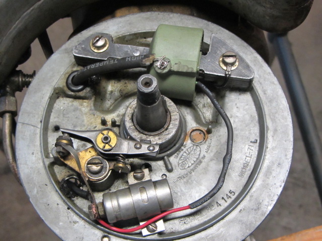

classicomctools@gmail.comOctober 9, 2017 at 7:37 pm #65973Richard, I moved the coil to the other end of the coil heel over the cuts. I put the flywheel back on and tested coil showed good. Turned the flywheel no spark . Took the flywheel off and found that the screw coming out of the coil was touching the bottom of the flywheel. Cut the screw down to half it’s length checked the coil ( bad ) did I ruin the coil by the plug wire screw touching the bottom of the flywheel or something else ?
October 9, 2017 at 7:43 pm #65977Pictures…. They will help immensely…
classicomctools@gmail.comOctober 9, 2017 at 7:55 pm #65979October 9, 2017 at 8:04 pm #65981OK, You can point that in any direction that does not hit the flywheel, so down or to the center are other options… Have you confirmed 2 things?

I also see another possible issue, is that coil wired properly? It is hard to tell as mine have a green wire and a black wire…. My gfreen wire goes to the points…
classicomctools@gmail.comOctober 9, 2017 at 8:18 pm #65983The points are clean , cleaned them made sure of that. I don’t know how to check condenser but the outer case and center do not read so they are not grounded. The green wire off of the coil goes to the points and condenser. The black wire goes to ground on the coil heel. Do you think When the coil screw rubbed against the bottom of the flywheel it blew the coil

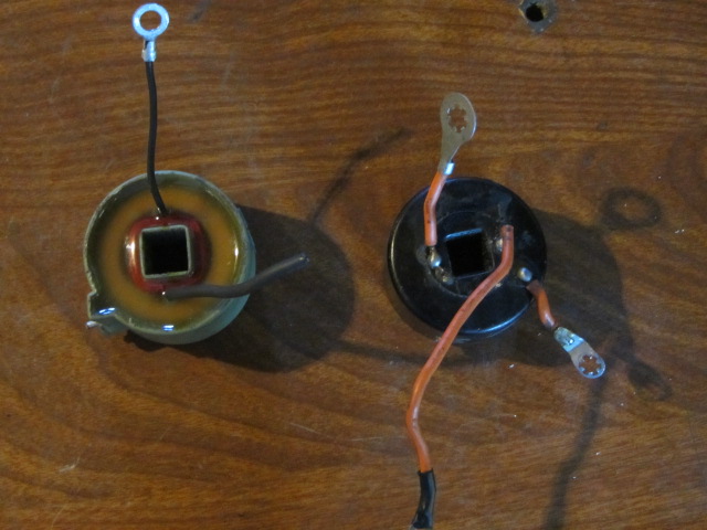

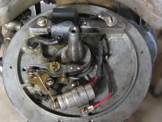

October 19, 2017 at 9:30 pm #66392I wanted to give an update on this post. I changed coils used a 3 wire hook up instead of the 2 that came on the OMC coil. The coil I used came off of a mag plate I had lying around. I hooked it up liquid taped the spark plug wire put the flywheel back on and guess what ? ( NICE FAT SPARK ) posting pictures of hook up. Thanks guys for all the help. Richard White , Frank R, Buccaneer and all the rest of you guys.
