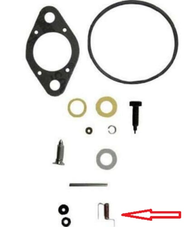

                #234661
                  I was just looking on Ebay, and I see a Walbro carb kit for the LMG versions,
                  which my Elgin has. Lo and behold, they show a spring like I found loose
                  on my work bench. The needle they show is different than mine.
                  I still can’t imagine how the spring they show attaches to anything.
                  Is it for the float needle?

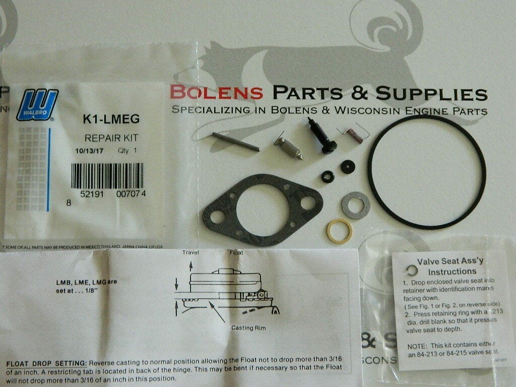

                  #234664
                    Found another kit, this one a better photo. It shows the same mystery spring,
                    but shows the float needle with a wire clip already attached.
                    If the needle in the kit already has a clip on it, what’s the spring for?
                    The needle in mine has no groove for any clip or spring to attach.
                    Pretty sure some on played switchero on the float needle.
                    Walbro-LMG-carb-kit2

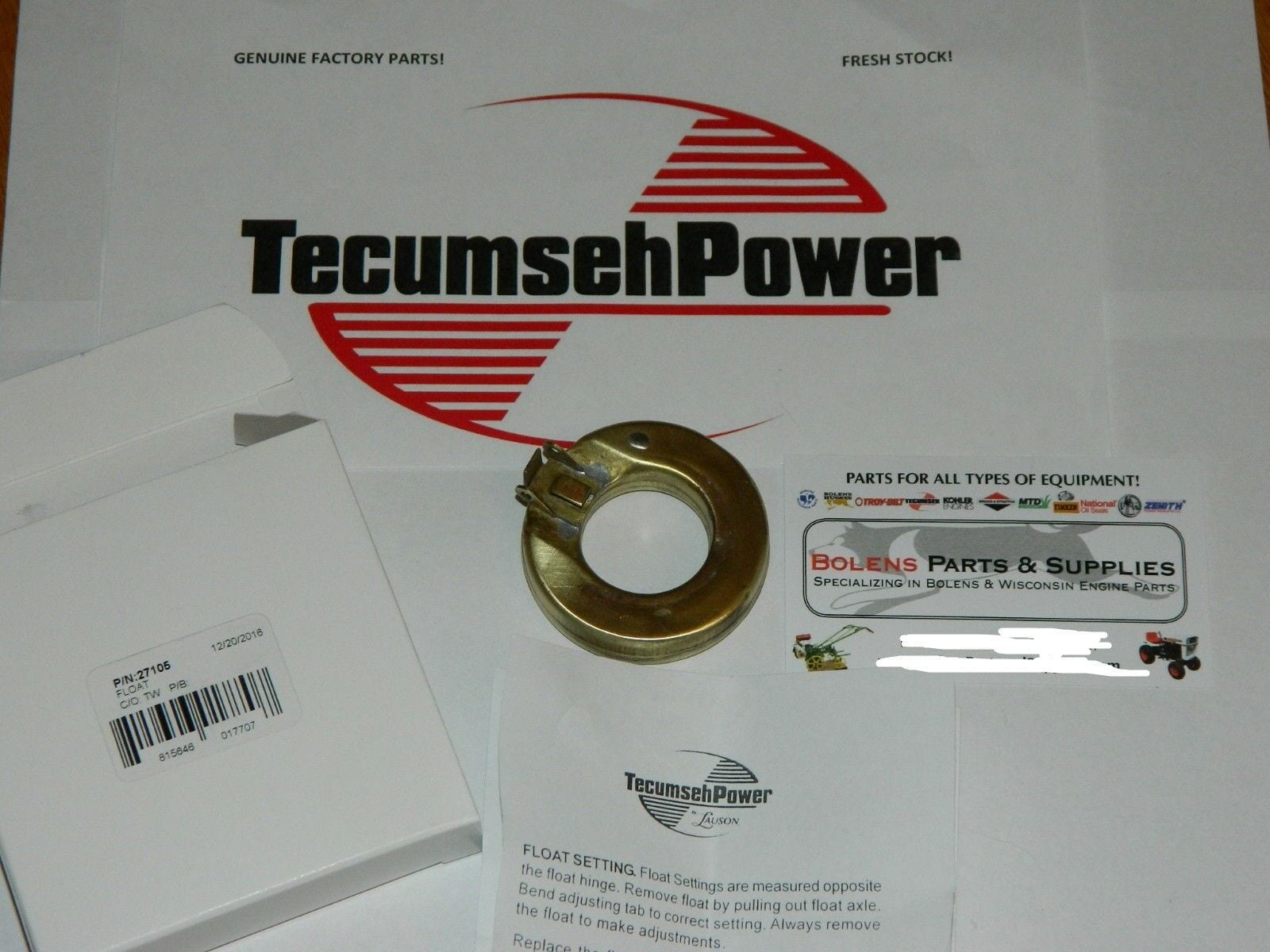

                    #234667
                      At least Ebay shows I have the correct float. Mine looks just like this……
                      Walbro-LMG-carb-float

                      DAN UMBARGER
                        That spring goes around the float pin and between the float pin flanges. If memory serves me correctly smaller Chryslers used this float setup. It’s hard for me to explain how the spring fits in but I believe it puts pressure on the float to keep the needle from sticking closed. Every time I do one of these carbs this spring is the thing that takes me the most time to reinstall because it’s not a normal system. Someone else probably can explain it much better than me.
