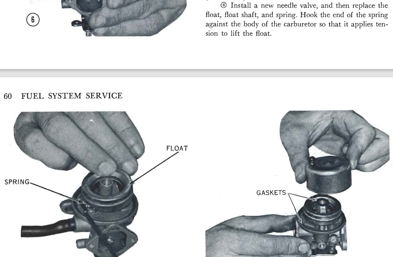

      Dan, thanks for the reply. I think you’re correct. I found the diagram below last
      night before “lights out”. It would make one believe the float pin goes thru it,
      but it must work in conjunction with the wire clip on the float needle.
      Looks like quite a lash up! ………. no wonder mine has the wrong needle…..
      probably out of desperation.

        1st, that definitely is a Scott-McCulloch. Secondly, the coil spring acts as sort of a counterbalance for the float. If. I ever knew the reason, I’ve forgotten by now. Lastly, does that carb have a pump bladder, probably in the mounting flange? It may be ruptured, if it has one.
        #234707
          Frank, your counterbalance would be as good a theory as any. To me, it’s
          just poor engineering, especially when carbs got along fine the previous
          forty years with no spring involved.

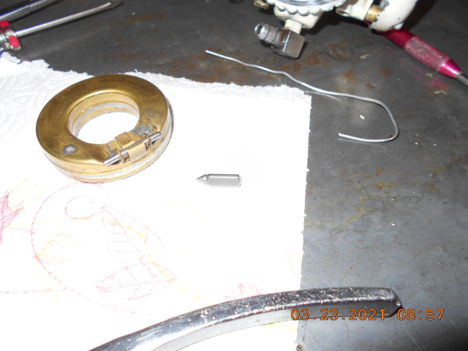

                    I’m wondering if the wrong needle valve I found in the carb,
                    and the float hinge pin spring I found on my workbench,
                    that I could not get to function correctly, and left off,
                    is “haunting me”?

                      I found this, but not much help because the picture is too grainy.
                      walbro-float-spring
                      #240700
                        Thanks Frank, I’ll pull the carb apart again tomorrow and take another look at it.
                        I messed around with that spring but never could make sense of it actually
                        working, but came to the conclusion I have the wrong needle valve, and
                        that perhaps somehow the two interact.
                        It’s a Walbro Carb, model LMG159
