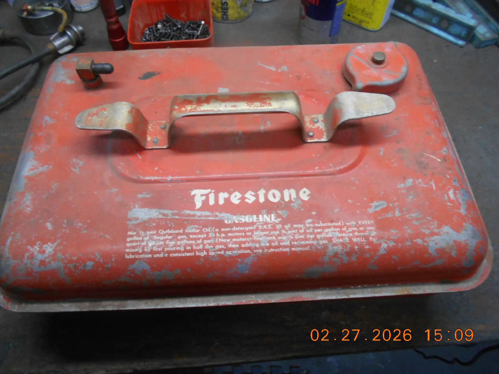

      I then checked out two identical single line tanks, except one is
      sporting an Elgin decal, the other a Firestone.
      Both are labeled to mix 1/2 pt / gallon, (16:1) but the Firestone says for
      over 30 hp, mix 3/8 pt / gal. (20:1).
      Any clues as to what year and HP motors they might be for?

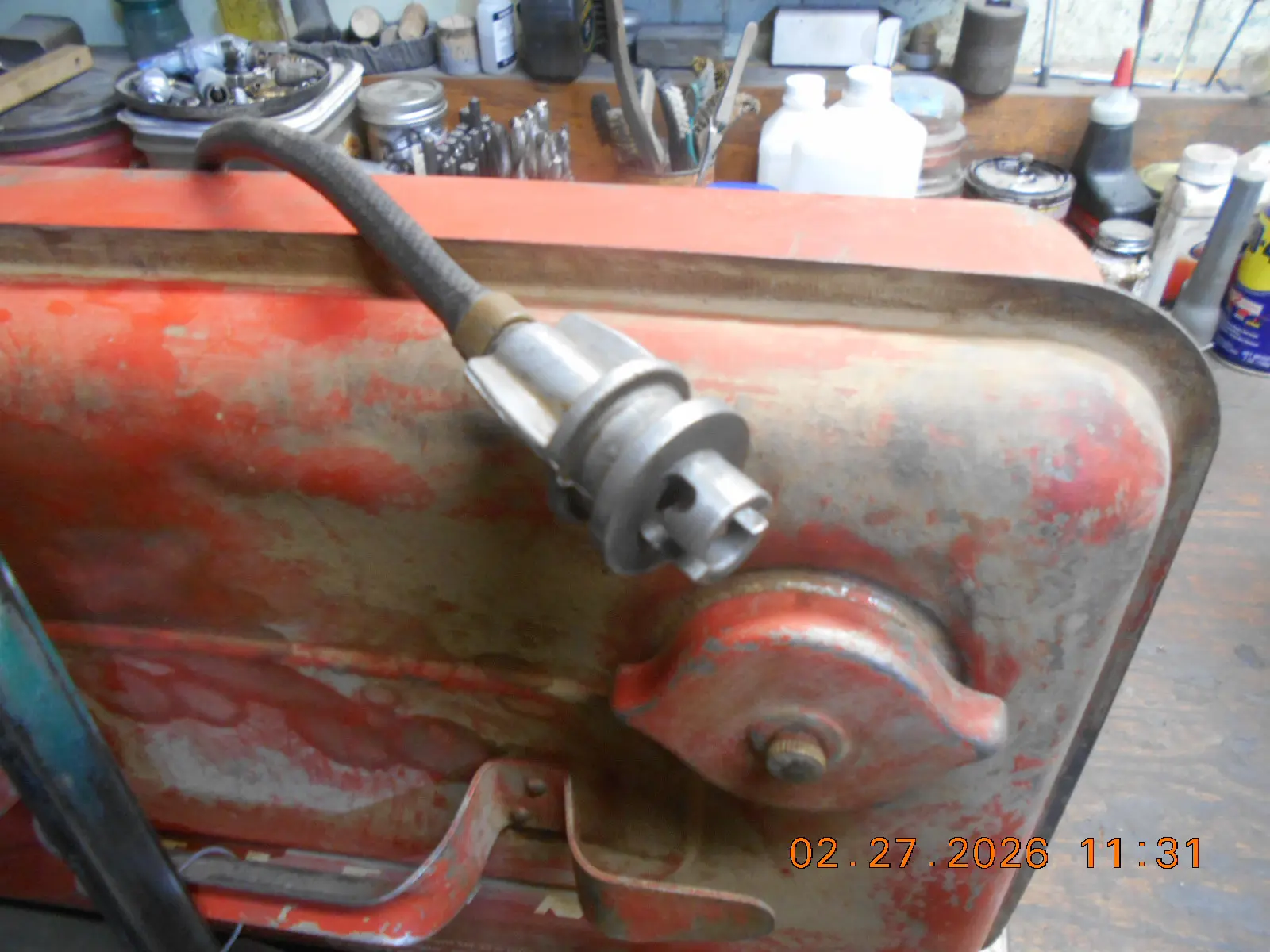

      Each tank hose connectors are identical, and look like they’d
      attach to a connector similar to a Mercury or Scott with a 1/4 turn
      twist connector.
      I did try hooking up the hose to one barb I had labeled as “Scott”, but
      the end that goes into, and past the O-ring was too long to be able
      to connect to the lock pins.
      I presume that these tanks are for Scott made motors seeing how the
      one is label Firestone.
      Any ideas? Thanks.

        Growing up we had a 1965 Sears Ted Williams 7.5 hp. I believe they were made by Scott-Atwater/ McCulloch. It had a aluminum 1/4 turn fuel line fitting that looked like your fitting in picture.
        #305115
          Thanks Gary, I finally found an early 60’s Elgin,
          I think 7.5 hp, on Youtube, showing the exact same
          connector.
          Hard to find photos of them, as I’m guessing most have been
          switch out for more common connectors.

            they also fit mercury SMALL fitting in a pinch.

              Thanks, I must have one of the Merc small
              fitting to try somewhere!
