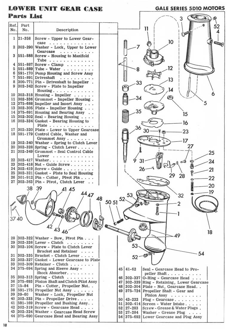

      Looking for a parts schematic fo the lower leg of a 1950 Elto 5D10E.   Mostly interested in water pump particulars 🙂

          Easier to read version:
          Pg-18-Lower-Unit-Gearcase

            Thanks a bunch,….mine is a Canadian version with clutch. The water pump in this pdf appears to be different from what I have…

              Yep, that’s the one.  Thanks a bunch!
