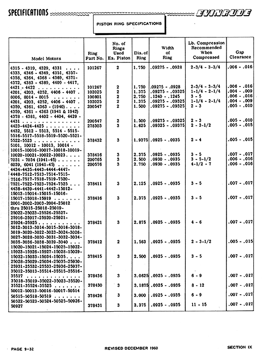

      A rule of thumb is .003 gap for each
      inch of bore. The gap is necessary
      because the ring will expand when it
      get warm. Too little is much worse
      than a couple .000 too much. I suggest
      .005.

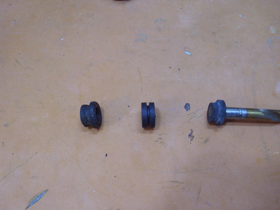

      Slim chance you’ll find the rubber grommet
      except in another motor so you make one.
      Search locally or on line for one and trim off
      one side. Sticking it in a drill bit and then
      removing what you don’t need on a grinder
      works for me. Best get a few.

        Ok, I’ll shoot for .005. I’ll check around at the hardware stores to see if they have anything that might fit. I’m always looking for more of these things. Maybe I’ll get lucky and find one that can’t be saved that I can use for parts. I had a Sportsman that I thought might have that piece, but it’s a later one with a different lower unit

            Here is what I have . . . 🙂
            #65975
              Is this any easier to read ?
