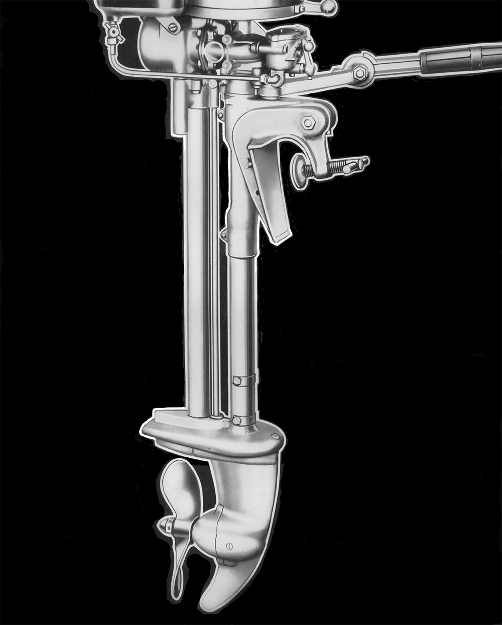

        This is the 1938 Ace swivel bracket.

          Thank you Garry. No driveshaft clamp in your Ace photo or parts list. I noticed the 1937 brochure Ace photo of the gas tank filler neck being in middle of tank so that my model 4145 1936-37 might be a 1937 (if original tank). I presume based on these brochure photos and 1936 parts manual that the changeover from filler necks from port side of tank to middle happened between 1936-1937? Also then the decal change-over from blue to the more common gold? I just wish someone would offer an early blue Ace decal in vinyl.
