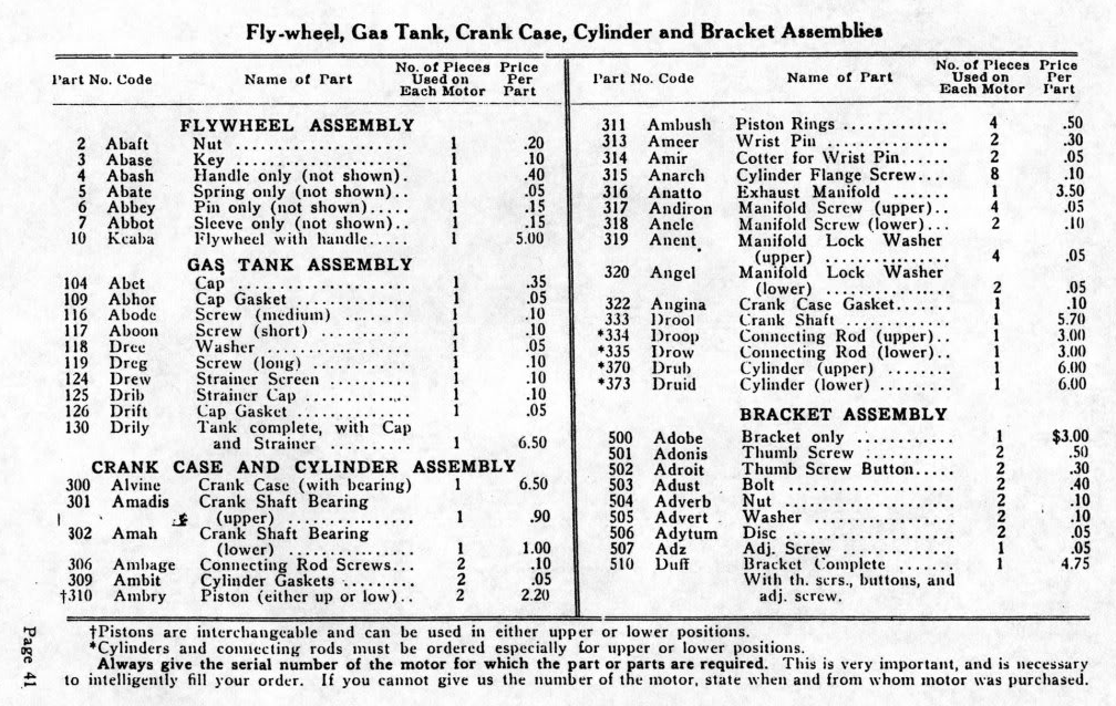

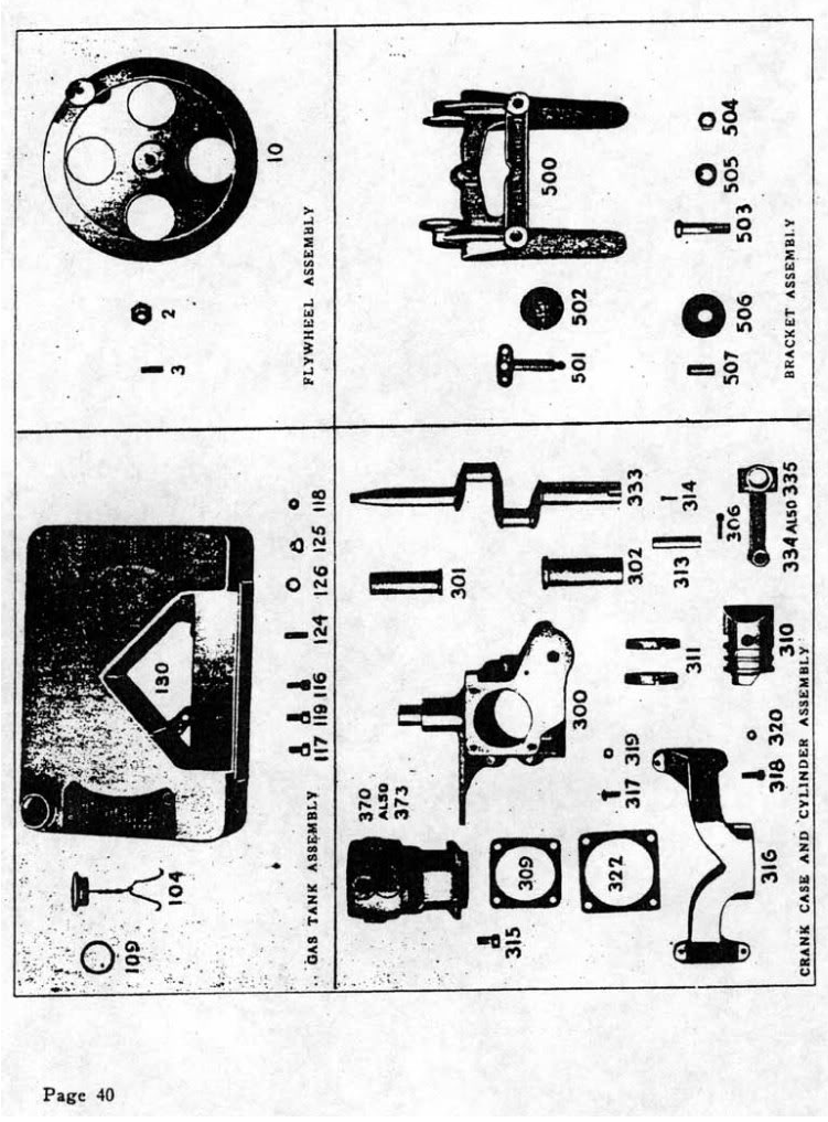

            #56737
            slim60
              Thanks again Gary; I’ll add that parts list to my files.
