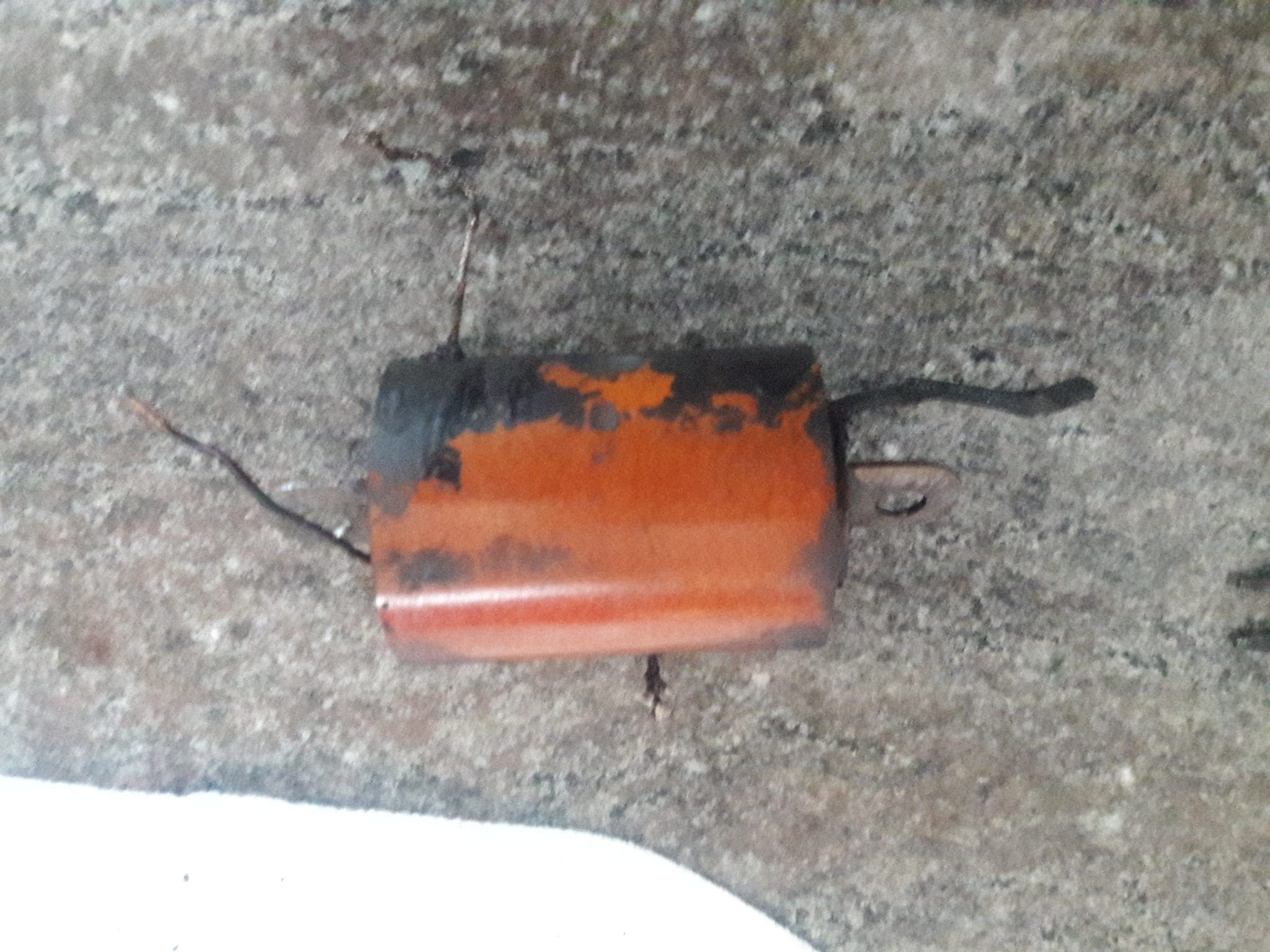

No known substitute at this time.
Do you have one?
Are you sure it’s bad?

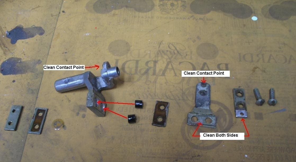

Have you tested it other than you’re not Getting a Spark?
These coils are rarely bad but it’s very common for
corrosion to occur within the point assembly itself.
Try removing them and giving them a good cleaning.
