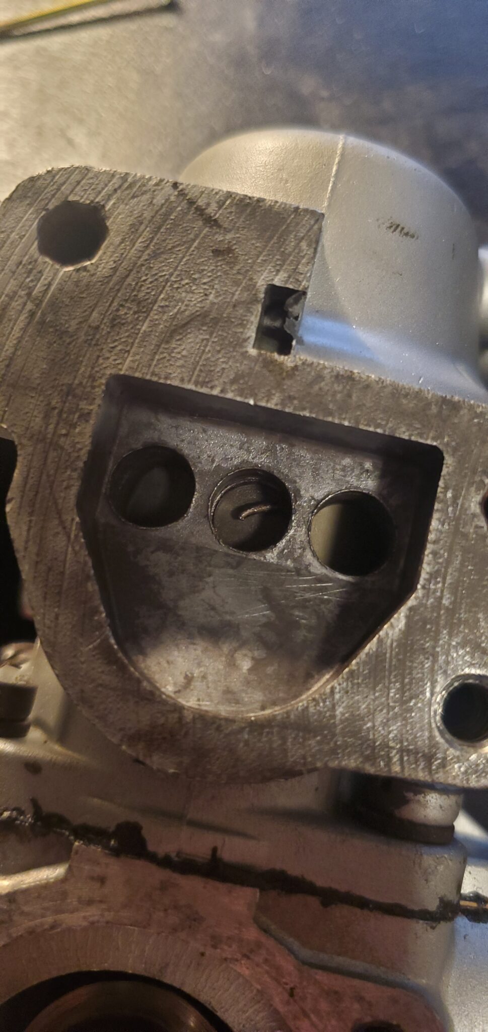

      II am a noice when it comes to restoring outboard engines. Finally putting this motor back together. I’m stripped the whole engine apart including the piston and ring. This is the original piston lock ring reinstalled. It looks a little suspect but this is how it was when I originally took it apart. Is it okay like this?
      I’ve been busy with college the last few years and finally got some more time to work on projects again.

        Its hard to tell from your picture with the
        pistons in the cylinder but the wrist-pin
        retainer need to be seated, all the way
        around, in the grove of the piston.
