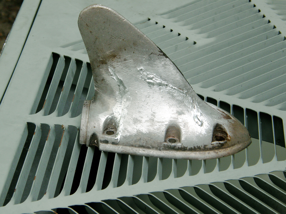

      I`ve had good luck with JB Weld.
      #13013
        Whatever works … πŸ˜‰
        – Didn’t look too bad after filing & painting.

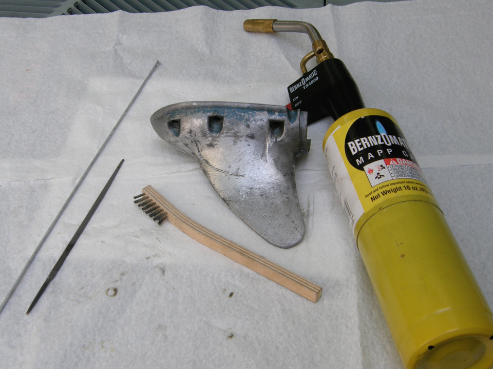

        #13015
        mr-asa
          Garry, I’ve never seen anyone braze or solder aluminum successfully. Anytime I have tried it I can’t get the heat level between the two pieces to mesh correctly. I usually damage the piece to be repaired by putting in too much heat. Any tips?
          #13059
            Like the N.Y. cab driver said when asked about how to get to Carnigey Hall, "Practice, Practice, Practice."
            . . . . . . πŸ˜€
            #13064
            kees
              International Member
              "NO" JB Weld for me,
              I donΒ΄t believe all the crap talk they say about it
              Okee , you have to try it, well….. I did, and…..
              I don’t move from my stand
              welding or solder aluminium and like Garry……..practice
              to practice
              heat a nasty part up and try…..
              the trick is, hold the aluminium solder rod not in the flam
              but move it over the surface in
              small circles behind the flame till it melts
              ( hope you all understand, English is not my first language and translations are sometimes hard ) πŸ˜† πŸ˜†

                Is it just me. That hole looks drilled. ???
                Scoot
                #13073
                TOM MACKIE
                  The drilled looking hole was drilled. The unwanted hole is 8 o’clock from the drilled hole. It’s small.
                  #13096
                  kennmatson
                    I suggest using some ‘brake clean’ to flush the hole out prior to epoxying. You can get some at any automotive supply. Kenn
