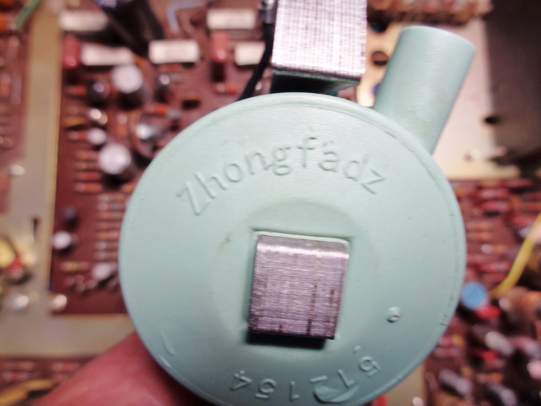

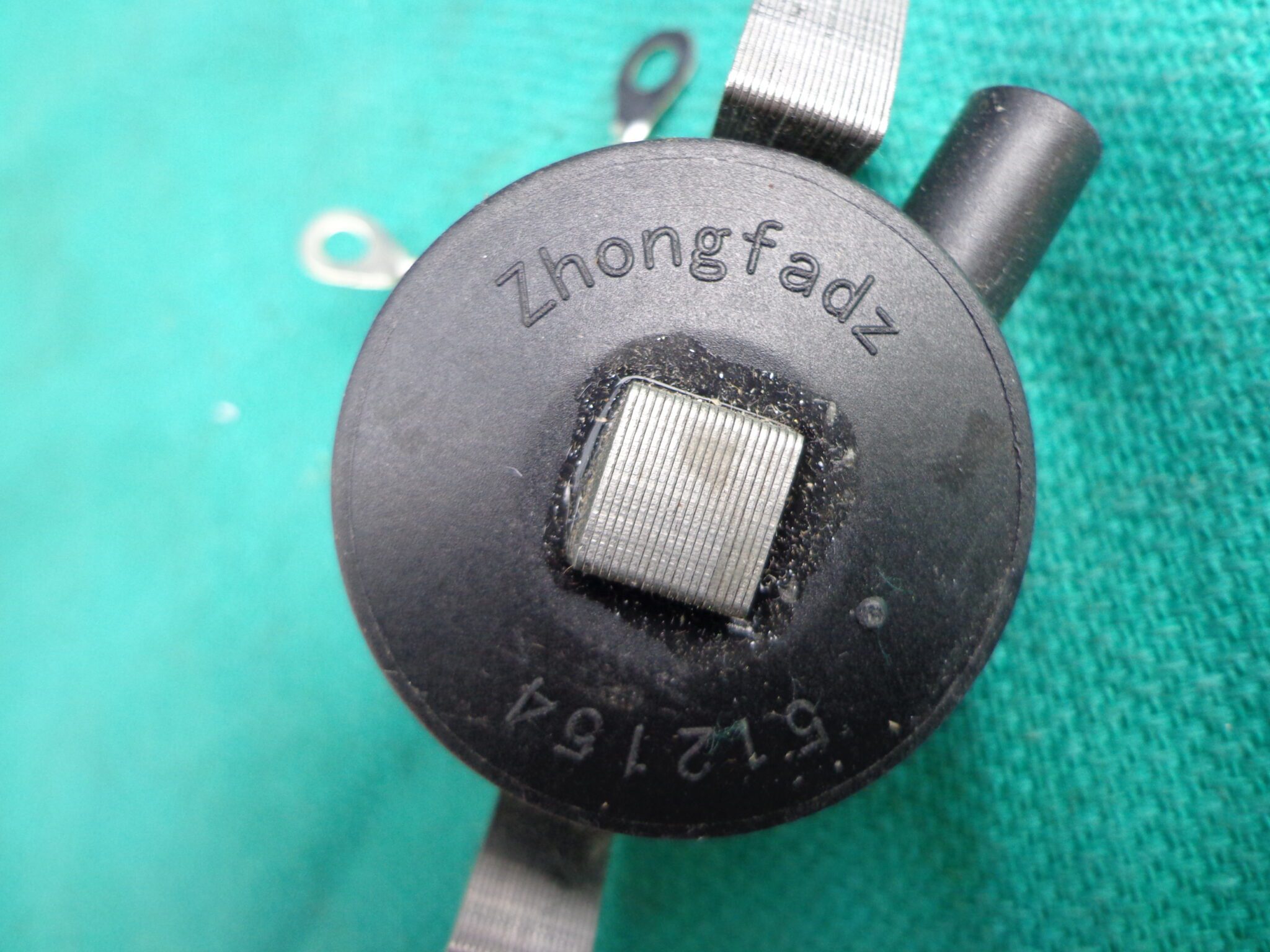

                  I’m sure there are more than one manufacturer of these coils and I wouldn’t buy them unless the have ‘Zhongfadz’ marked on the end of them. I’ve had good success with this brand but your mileage may vary. The worst ones I’ve seen for fit were from ‘Never Any Parts Available’ auto supply.
                  DSC00124-1
                  DSC00416-1
