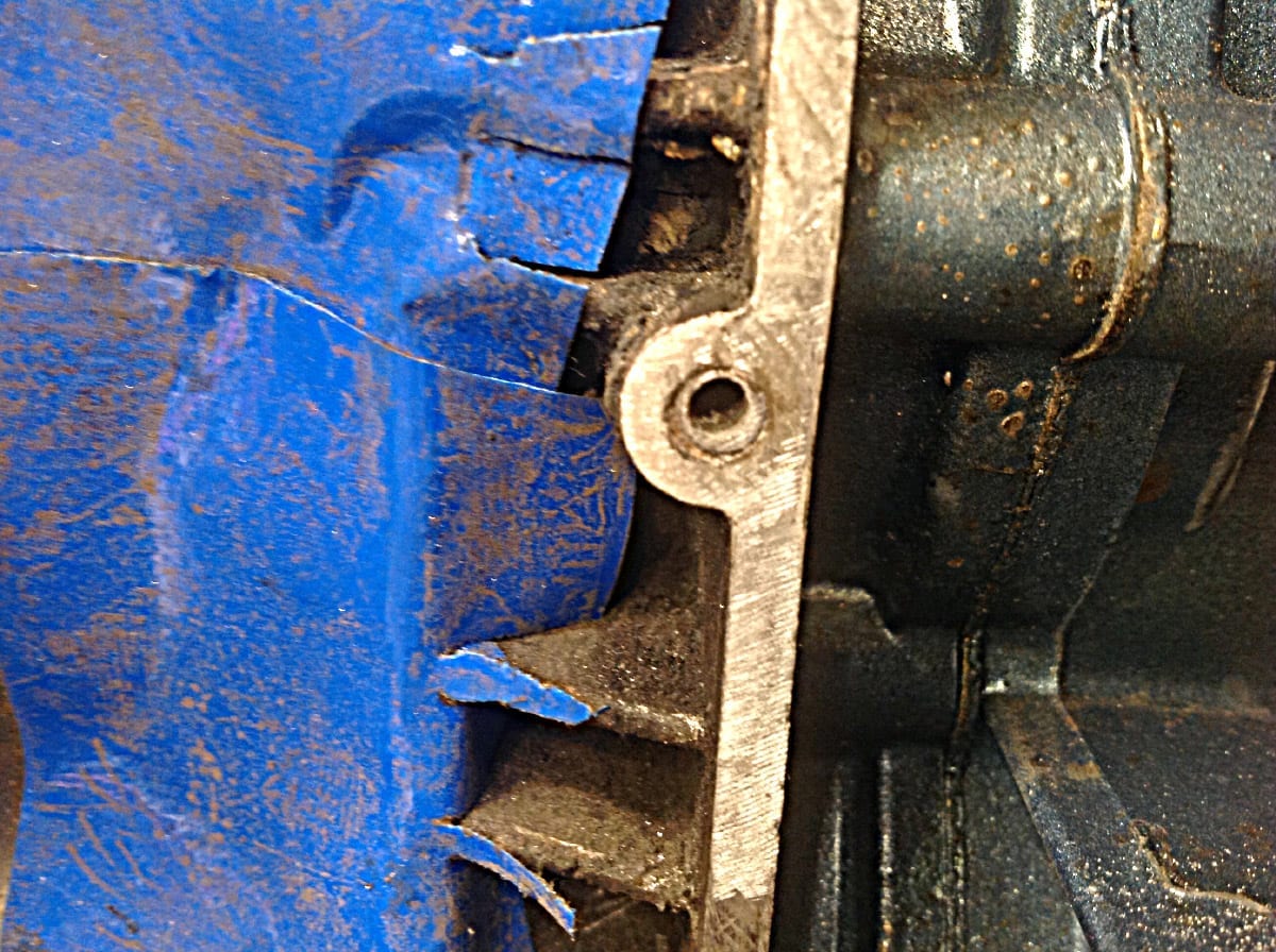

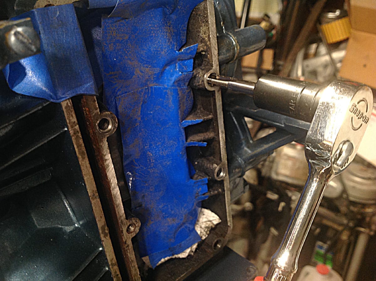

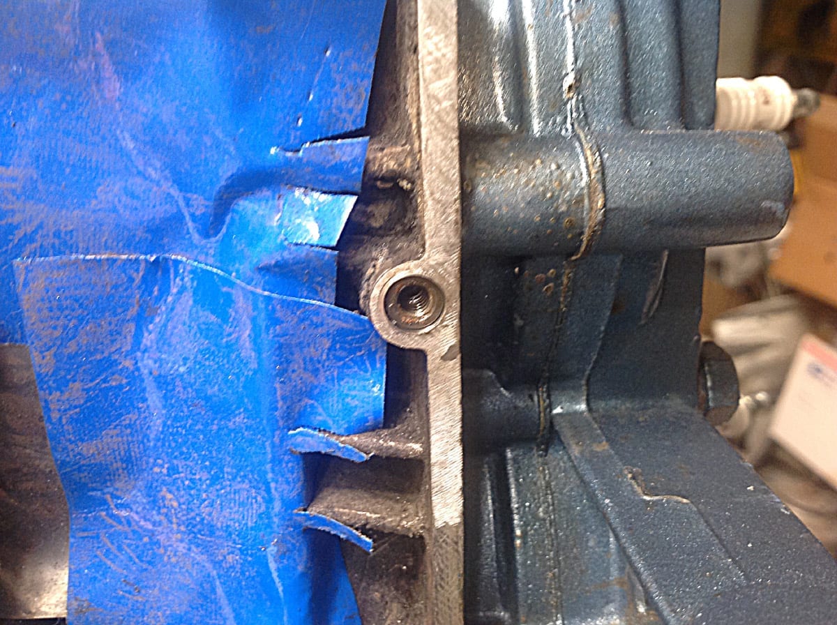

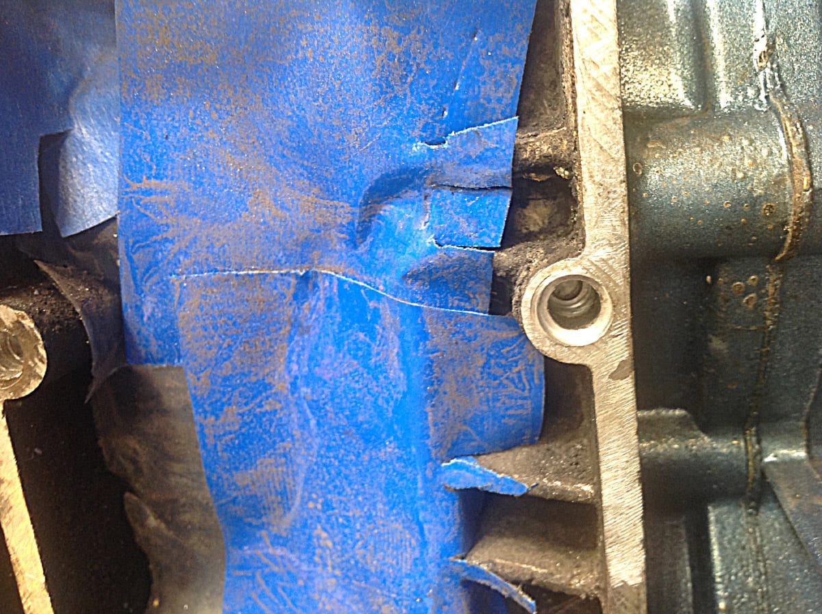

                Crowsbeak here are the pictures of the Time Sert repair that you requested. Basically done in four steps:
                Drill out existing bolt.
                Use countersink attachment in kit.
                Thread hole for Time Sert
                Thread in Time Sert with their special tool provided in kit.

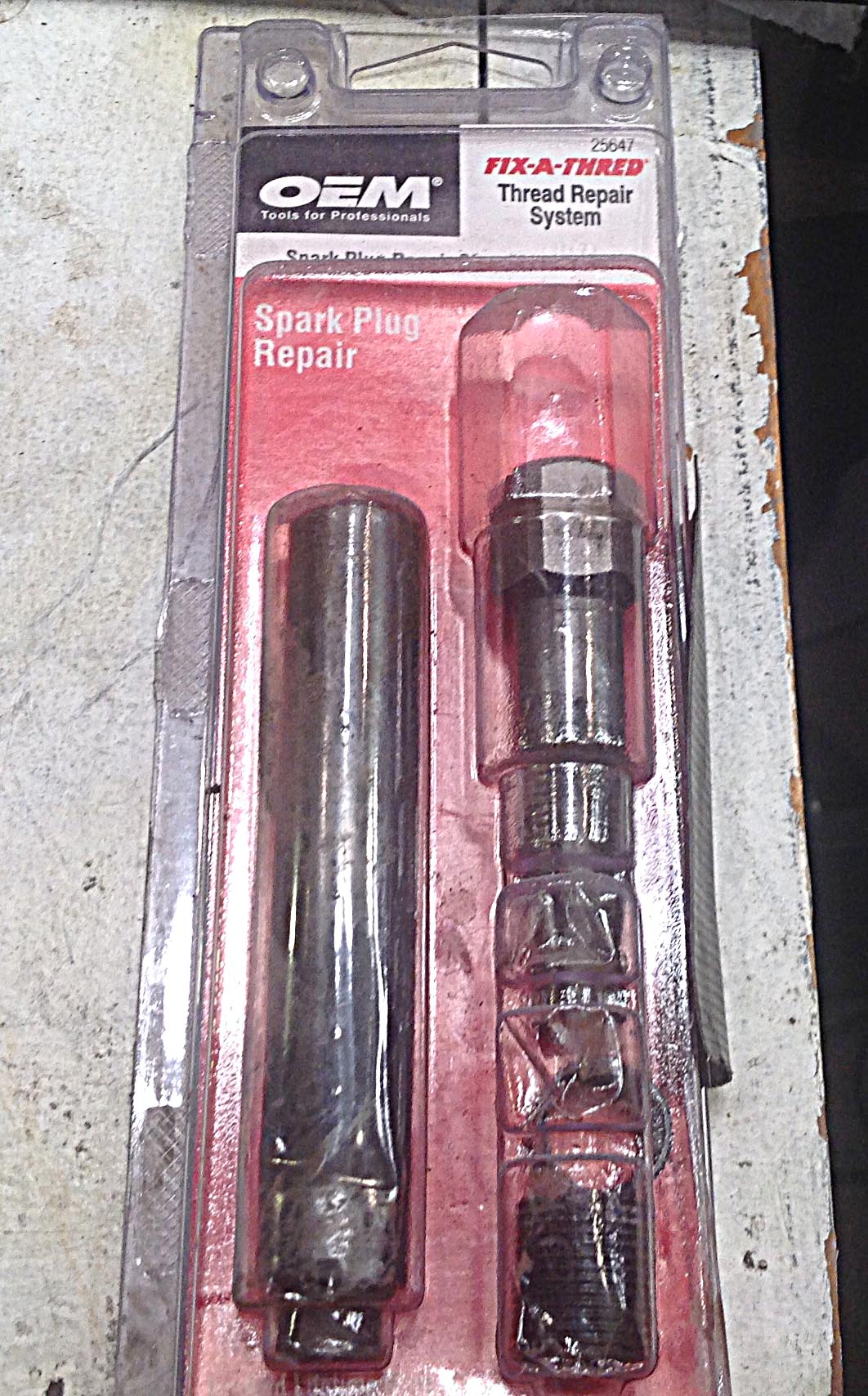

                Bill W, I agree with you regarding not using this type of repair for a cylinder head. I tried the brand below in the picture for a 51 Johnson 10HP and experienced the same problem that you had with the threaded portion coming out with the plug. Ended up just getting a new cylinder head.
                It was not made by the Time Sert company so I don’t have any experience if they have a kit that would work. I do believe however that for mangled bolt the Time Sert repair is the way to go.
                Bob D

                bob-d
                  This is the brand insert that did not work on a spark plug hole.
                  Bob D

                      AT our resort back int the early seventies we started to use the timesert style inserts for spark plugs.They went in great but even with red lock tite most backed out.It was a real dissapoinment as they worked so well.
                      #204066
                      bob-d
                        John, I totally agree. I’ve tried a version of them (noted above in the picture), and they didn’t work for head repair applications. I still swear by the Time-Sert brand for broken bolts holes. Outboard heads are usually not too expensive, and generally available. I now just replace if I have a problem.
                        I once was on the lake with an1948 Neptune 1.7HP. I knew that the head threads for the plug were kind of dicey. Started it up, accelerated, and all of a sudden heard and loud bang. The plug shot out about 10′ out the back of the boat into the lake. That was the end of my short trip.
