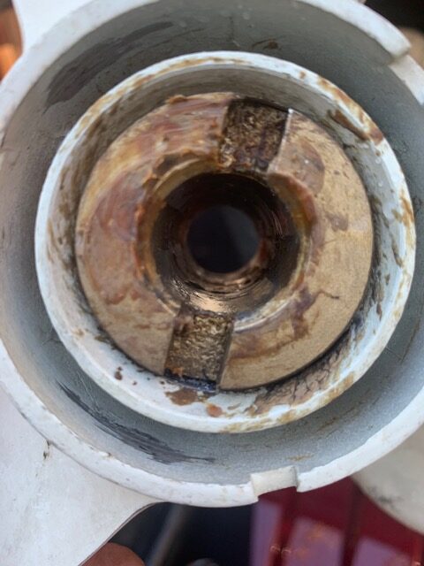

                IMG_4157
                here is a photo fleetwin….did these have rubber? I do not see any evidence of rubber thanks again for all the help

                  my photo does not seem to be attached

                    Here is the photo I hope
                    IMG_4157

                      Ok the prop is getting rehubed. And I will buy a spare. I am sure to have more questions. So I do appreciate all the help
                      #247419
                        Looks like relatively new prop…Perhaps it was just reworked. There is a rubber hub in there, just can’t see it. Hoping the new prop solves this issue…
