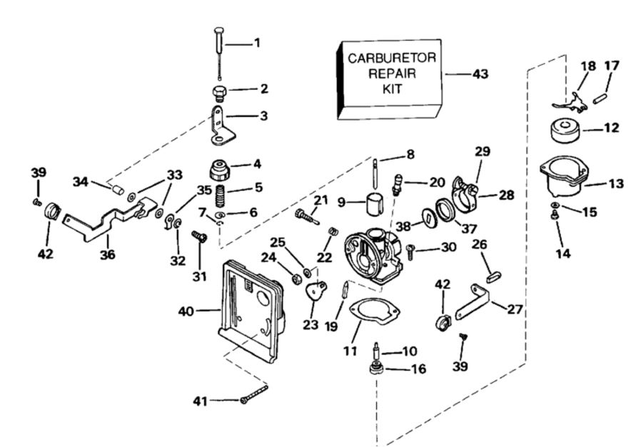

      I know this isn’t an antique outboard but I figured I’d ask here first. I picked up a 1992 omc Hong Kong 2 hp motor and it ran like crap. So I took the carb apart and inside seems to be a "restrictor" plate of sorts. Has anybody worked on these and if I take it out will it give me more HP or just problems. Thanks in advance!
      #58594
        Would that be a 3.3 horse motor? I can’t find a listing for a ’92 two horse.
        Are you referring to #38 here in the diagram? If the motor doesn’t have a pressure tank attached, it’s too new for me to know what that item is but it sure does look like a power robbing restrictor of some kind.
        #58619
        timmy3131
          Yes sir! Number 38 is the piece I’m referring to. The motor says 2.3 on the cover but I don’t know much about it.
          #58622
          kerry
            2.3hp with restrictor, 3.3 without, maybe? Or, it could be there for a totally different reason, and run like crap without it. If you try running without it, be mindful of RPM’s so it doesn’t overrev.
            #58698
            enrico-italy
              I also have a similar motor (1997).
              Removing the restrictor plate all the mechanicals are the same of 3.3, but I noticed in part lists the ignition box also is different from 2.3 to 3.3.
              This problem don’t exist in the first Model Year ( 1991-1992) with breaker ignition circuit
