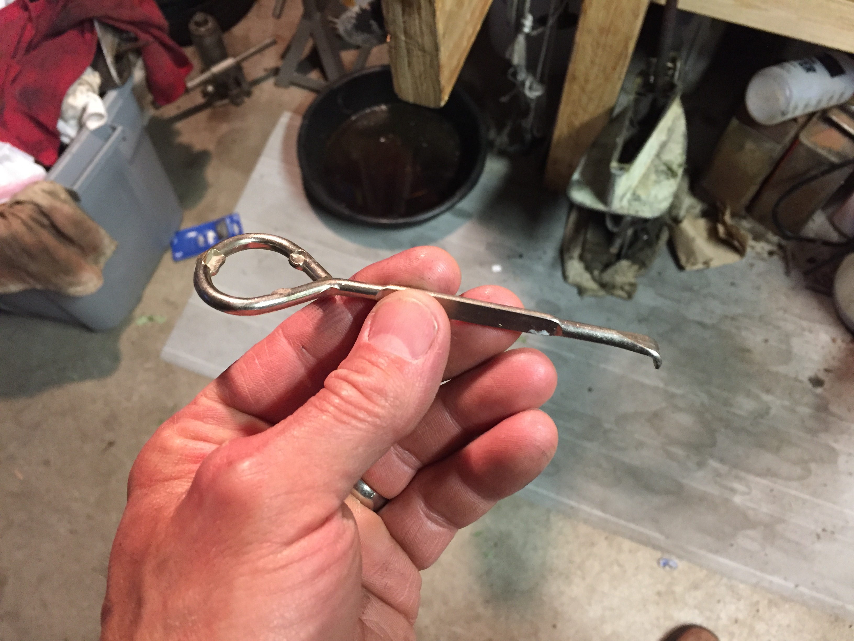

        opposedtwin
          What about this tool? Believe ot or not, this paint lid remover has come in handy many many times for me over the years. May not be quite long enough to reach it but it could be "customized" to make it work. 🙂
          #59097
            So far it wouldn’t wiggle with a needle nose or screwdriver.
            Unfortunately, I have several of those paint can openers,
            as every time my wife thinks I need to change the color
            of the living room or kitchen walls, the hardware store
            gives me another opener!
            It will come out tomorrow….. one way or another 😮
            #59136
              Update, this AM I tried compress air, blowing in the
              center hole of the thrust bearing….. no go, it’s too
              open behind the bearing.
              Tried the heavy wire / hook method….. no go!
              Finally screwed a 12-24 tap into the center hole
              a ways and pulled….. popped right out. Surprised
              to see it’s some kind of plastic.
