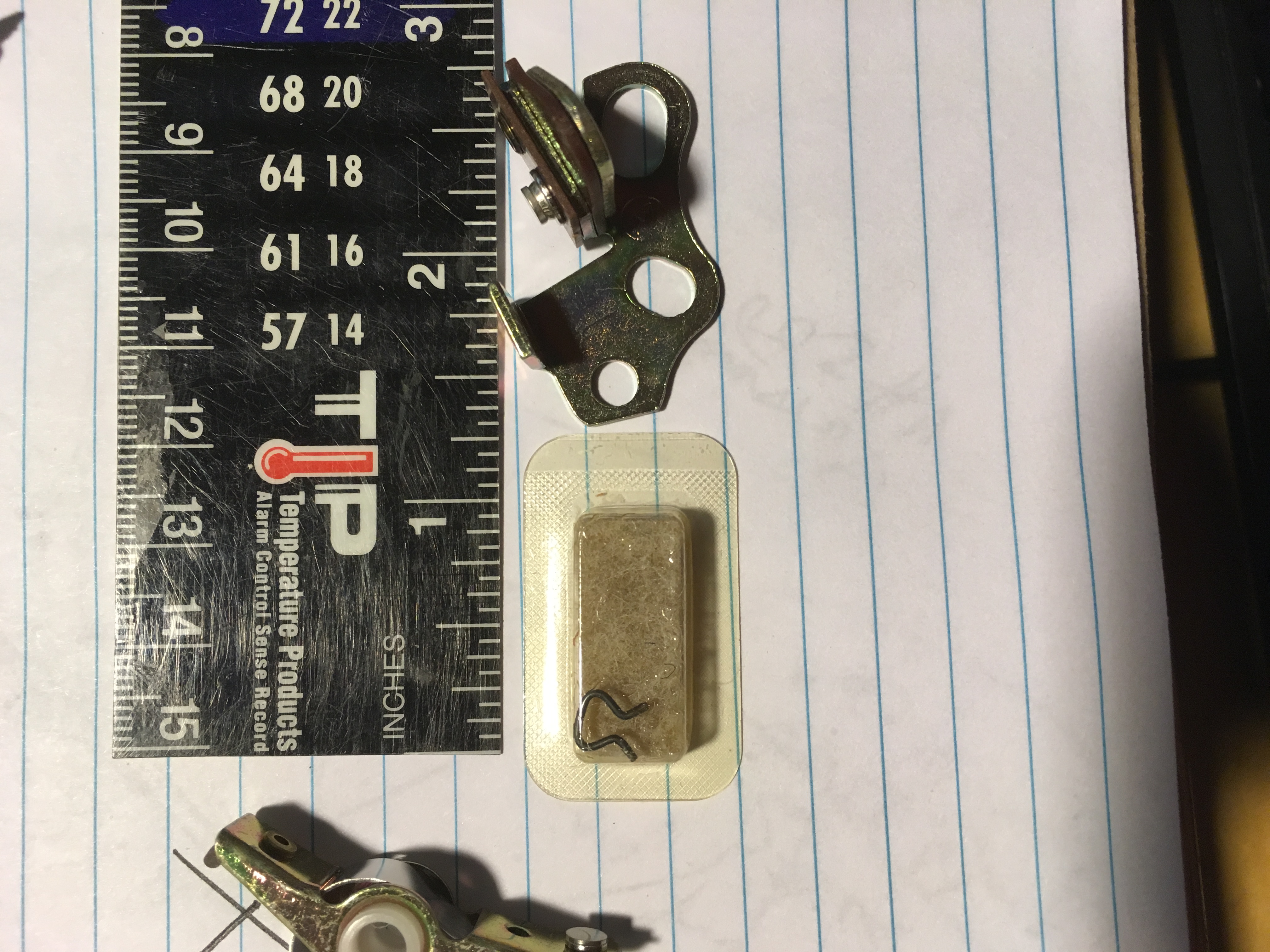

              #41344
              fishbrick
                Could someone post a photo of oiler wick installed. And also what are the dimensions of the wick.
                #41349
                  Sorry, I don’t know the dimensions. About yay by yay by yay.
                  20mb image hosting
                  #41356
                  mr-asa
                    3/8"x3/8"x3/4" or so?
                    #41360
                      nah, more like 1/8 thick. 3/16 at most.
                      #41391
                      david-bartlett
                        About 1/8" x 3/8" x 7/8".
