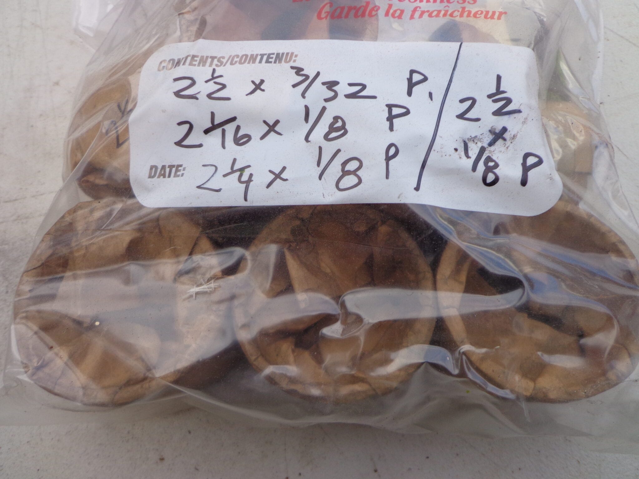

        I have boxes and boxes of NOS rings in different sizes and if you get stuck, I see some 2 1/16 X 1/8 in the pile. I make fixtures to hold rings and that way they can be turned to the proper thickness.

        Mumbles, that must be quite the feat to hold a ring in a fixture while you
        machine it down. If you have any photos of said fixture, I’d get a kick
        out of it.
