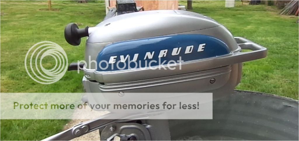

MY GRANDFATHER BOUGHT IT IN 50S MY UNCLE JUST GAVE IT TO ME I GOT IT RUNNING MADE TRANSOM ON MY 19′ PRINDLE CAT SAILBOAT
IT WILL RUN 8 MPH. IM A WATERSKIER/BAREFOOTER I HAVE ALWAYS HAD MOTOR AND STEERING WHEEL NOT A GOOD SAILER.
MOTOR LOOKS GOOD GRAB HANDLE ON REAR BROKE
Since the original snap-in type rubber seals have been obsolete for eons, those two SKF seals were the only ones I could find with the correct sizes to replace the originals in my 4423 and 4425 motors. I used some sealer when installing them and they have been holding gear oil for over a year now. They’ll work!
THAT MOTOR IN PICTURE LOOKS LIKE NEW.
OK ON THE SEALS I WILL DO THAT.
IS MOTOR IN PICTURE A 4425 CONTROL ARM LOOKS DIFFERANT
