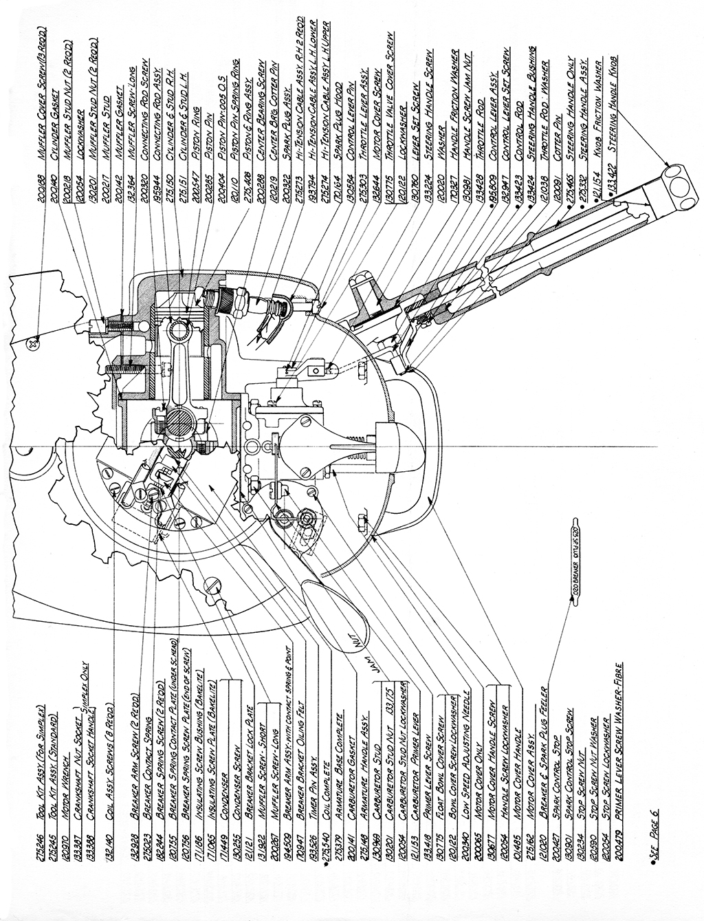

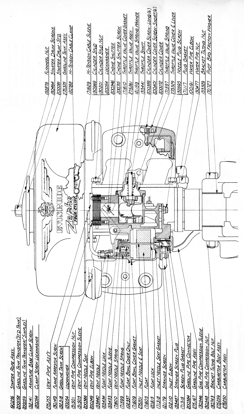

      Early Zephyrs used the same packing as the high speed needle. Later models used an adaptor and a smaller needle. . . 😀
      1940 Zephyr
      1948 Zephyr
      1949 Zephyr
