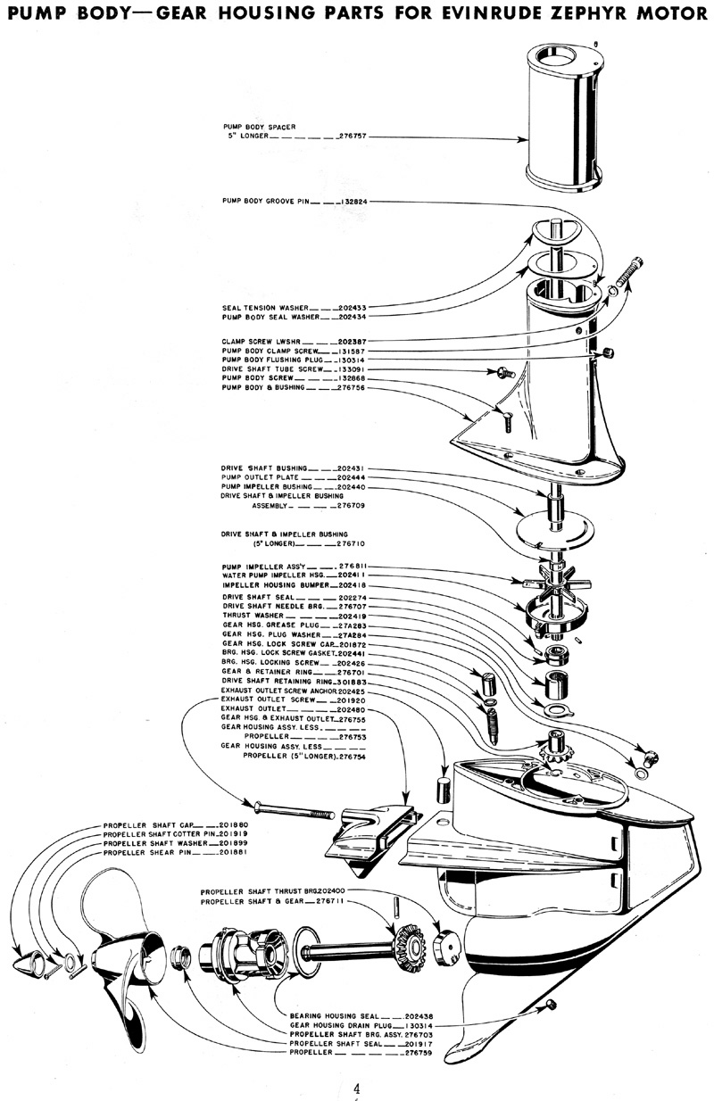

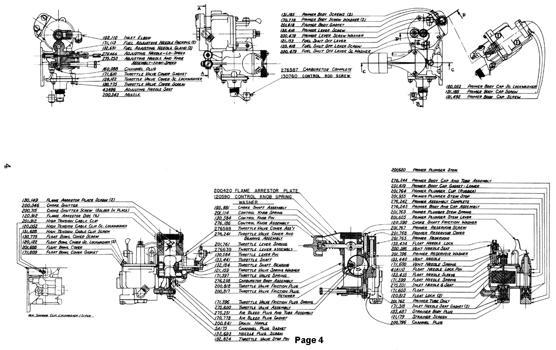

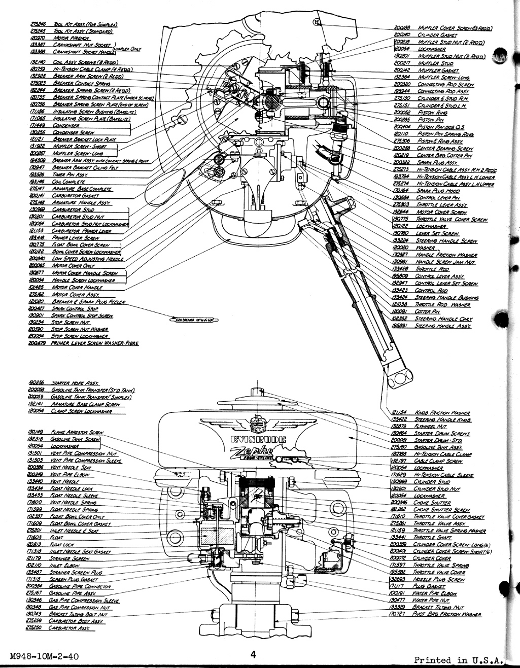

April 7, 2015 at 3:33 pm #13481You need Parts books? – Model 4359 …
Model 4402 …
Model 4431 …

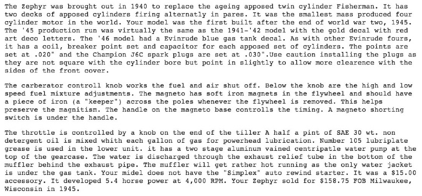

April 7, 2015 at 5:39 pm #13493I wrote this up for the 1942/1945 model – later motors have alnico flywheel magnets and a more reliable ignition.
They synchronized throttle and ignition in later models, eliminating the twist grip tiller. Customer complaints made them bring it back on later models. The push button primer was another addition’ as the old method of pushing the float pin down had a tendency to flood the motor with fuel.
