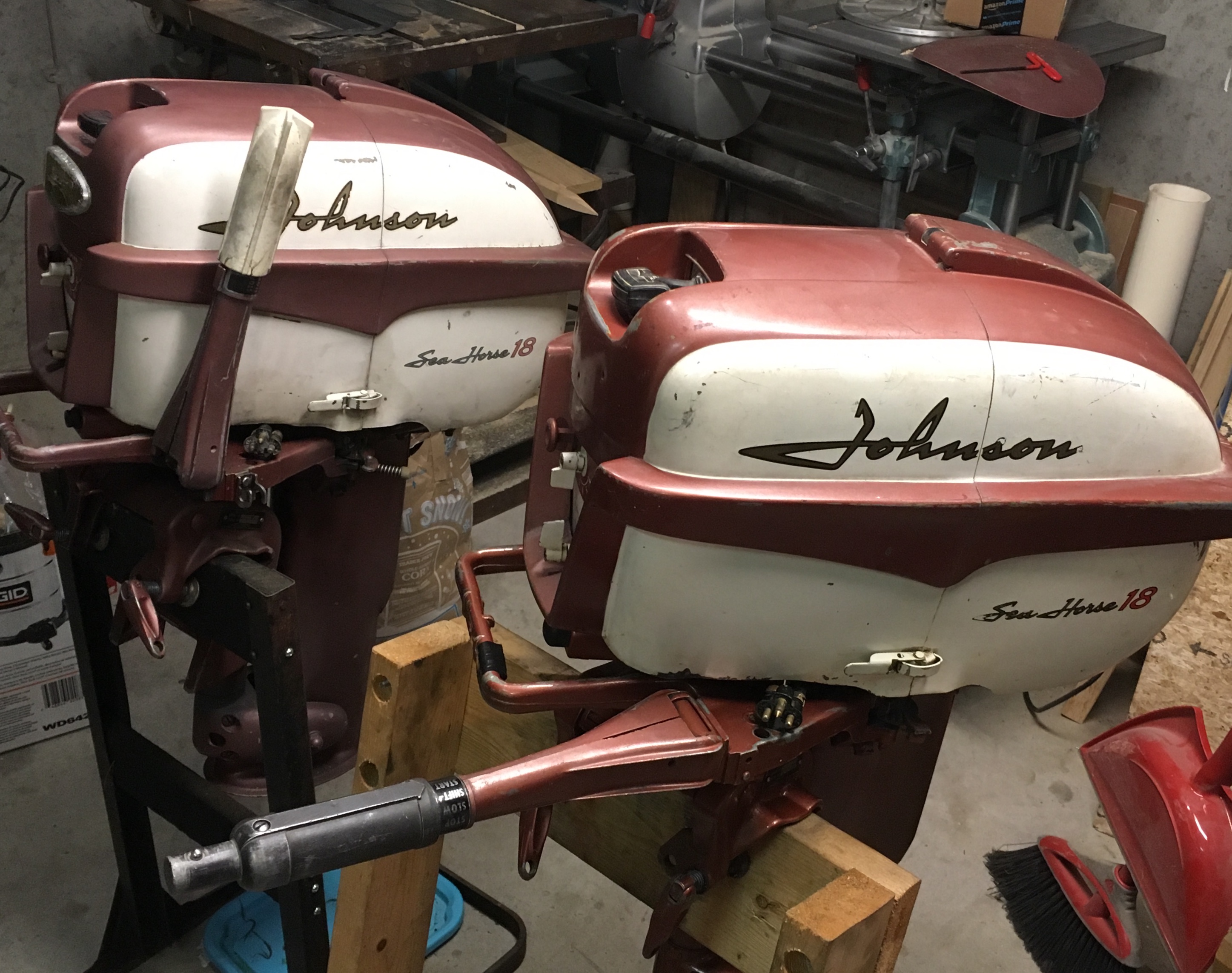

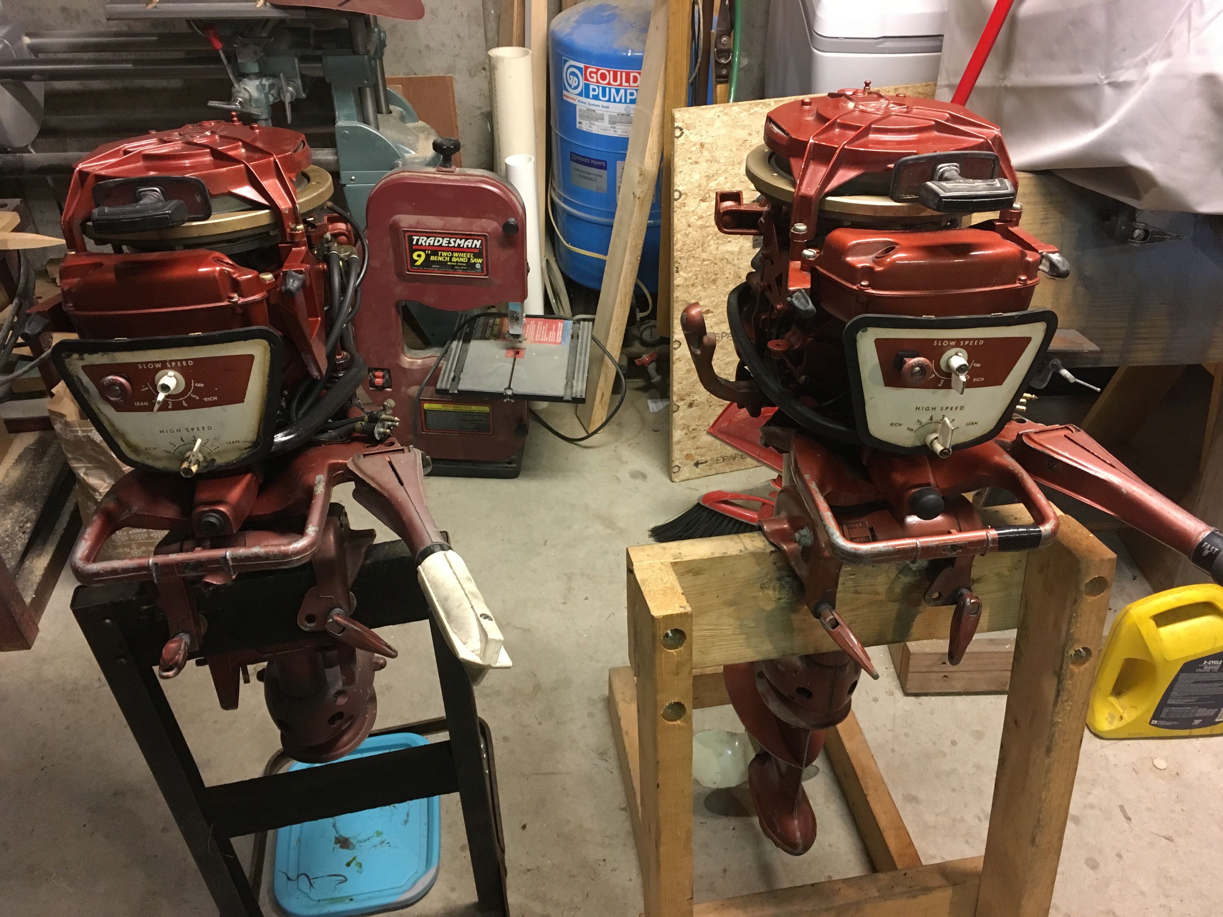

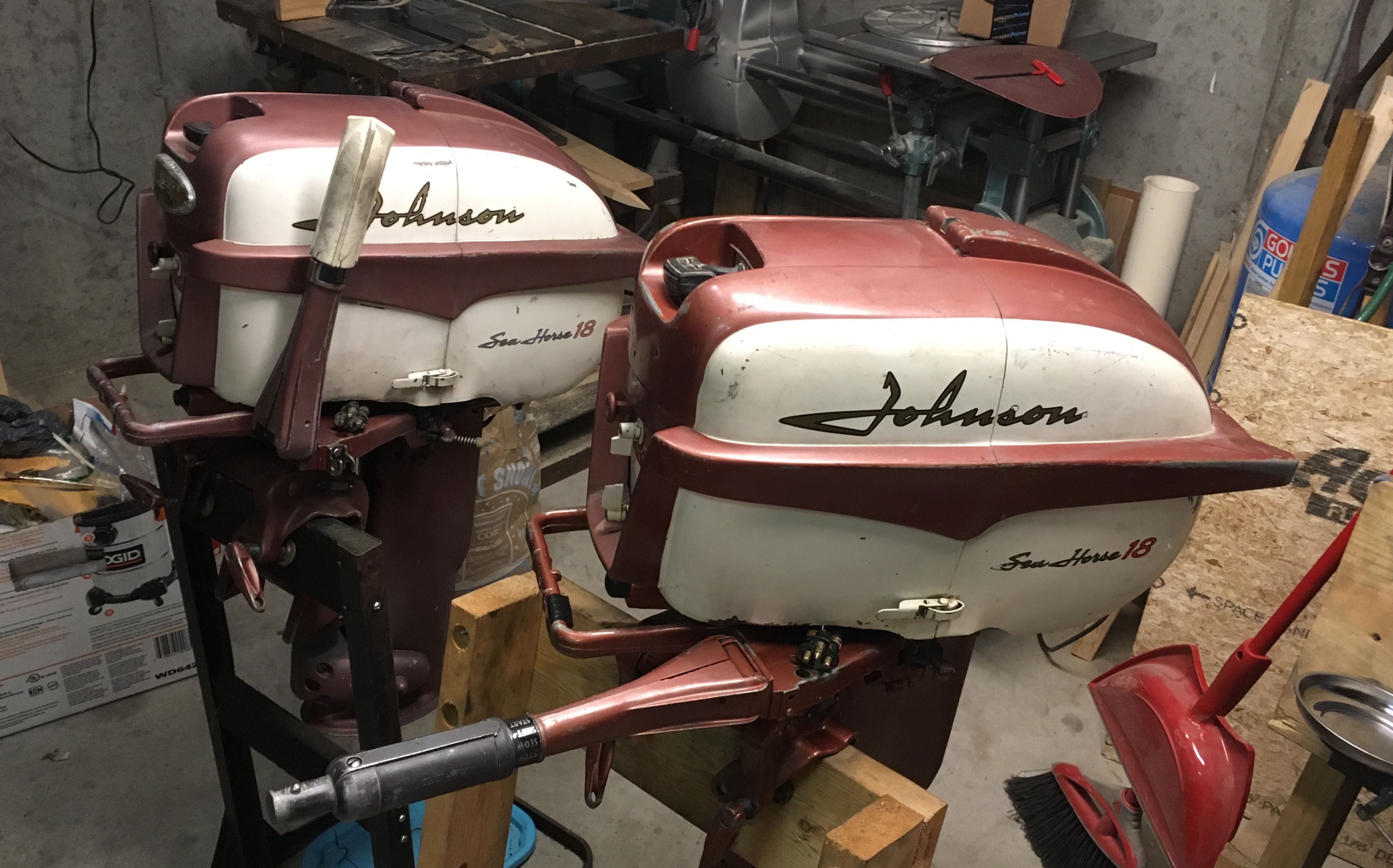

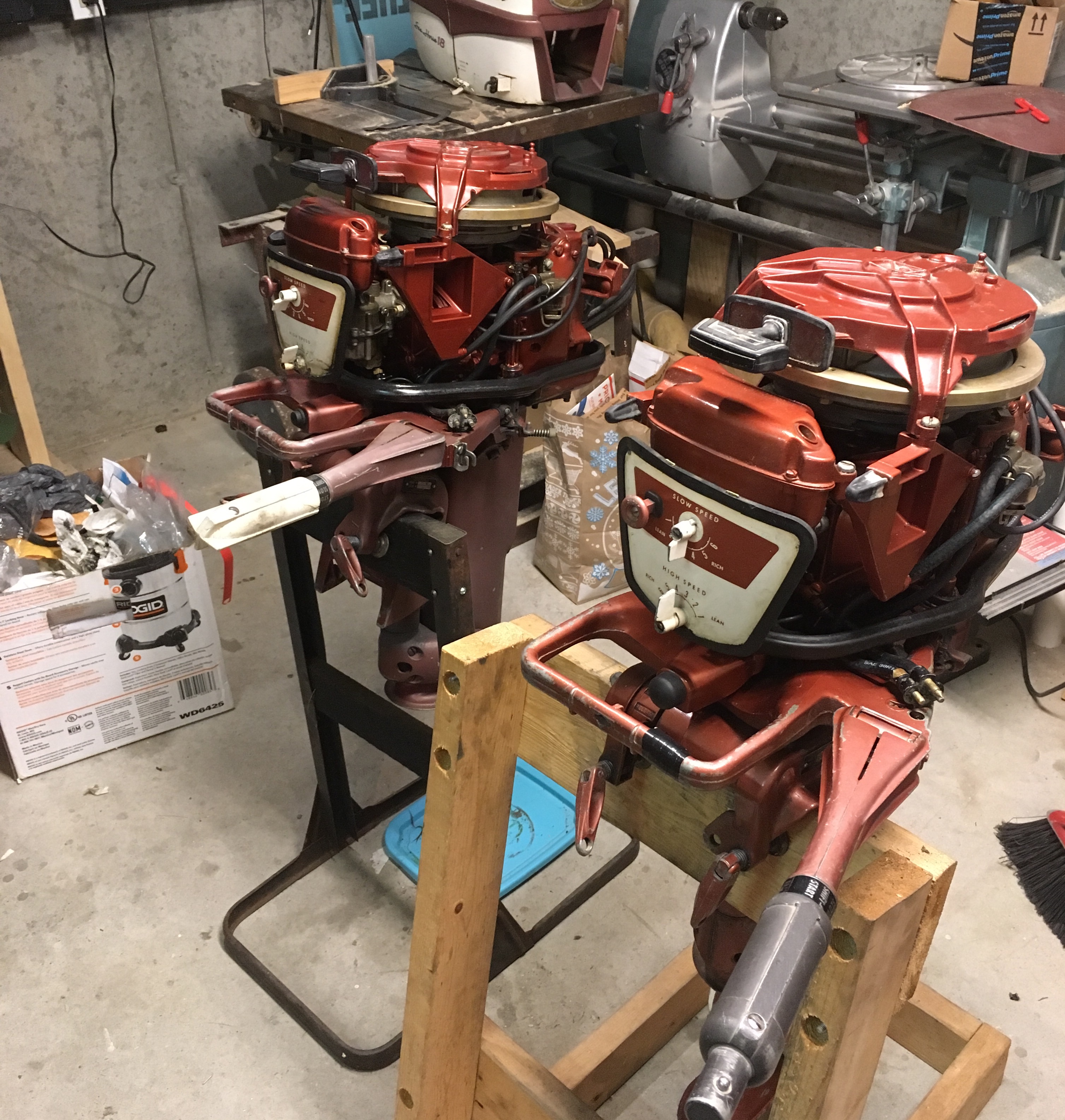

          Good question! I replaced the ignition wires and spark plug boots. Insulated the stop switch with liquid electrical tape, and checked and adjusted the rest of the mag assembly. New seals and impeller in the bottom so now just need some warm water to find out.
          Here it is next to the next one on the list.
